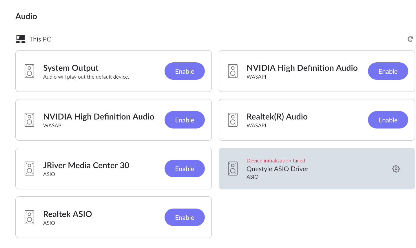

I recently purchased a Questyle CMA600i. When I go to Settings-Audio, I see the driver but when I try to enable it, it says “Device initialization failed”.

I tried it on two different computer, one with a fresh install. On both computers, Roon did not work, while JRiver Media Center 30 did. So JMC had no problems with the driver.
Try WASAPI not ASIO driver. Some hardware (USB route) not work via ASIO but perfectly play via WASAPI. Windows 10H2 and after ver. have 2.0 support (USB 2.0) but sometimes USB interfaces on HiFi DACs not work correctly.
