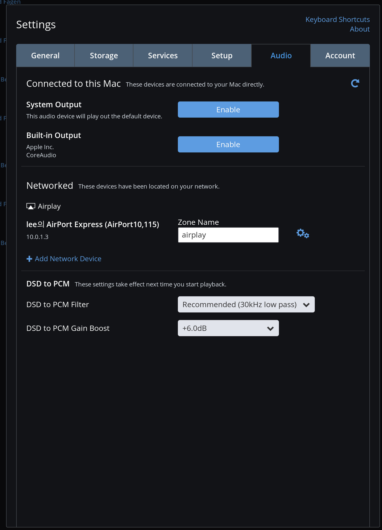

I’ve get same problem. PS audio PWD+ Bridge2 can’t be found.
I installed roon and Roon Bridge
Upgrade Ps audio Roon ready 2.9.7+bridge 2.15
I read your knowledge base and community posting.
But I can’t solved problem.
Would do you support me?

The PS Audio needs to be Enabled in Settings>Audio tab. In the screenshot above, you just show Storage.
Can you post a screenshot of Audio?

One thing I noticed from this screenshot is the N/A beside firmware update. Is the Bridge II firmware installed properly?
On the PS Audio website, it shows updating the Bridge software (near the bottom of the page) and there should be a version number showing.
Bridge II is built into DirectStream Junior, and available as a network streaming option for DirectStream and PerfectWave DAC customers.
Bridge II, with the latest firmware installed, can become a Roon Endpoint - making any of our DACs...
Cheers, Greg

I don’t see the indication of Bridge II version or the Torrey’s in that image.
shouldn’t it look like this?
perhaps you need to get on the PS Audio forum and get hold of Dennis

It looks like you have a bridge I, which does not support Roon.
Dennis
