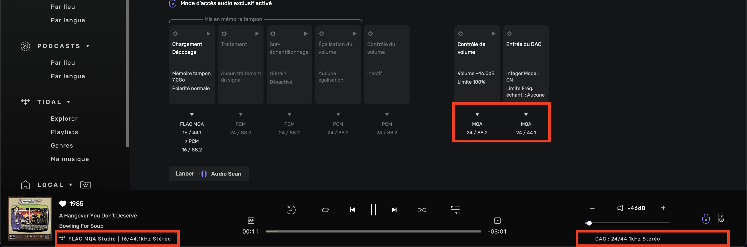

This is what’s being displayed on Audirvana :
As you can see, the values are quite different. The track that is playing is an MQA Studio one. The fact that I can’t see any 192kHz to make the comparison is kinda bugging me but maybe I’m not understanding the values correctly, you tell me.
You aren’t
