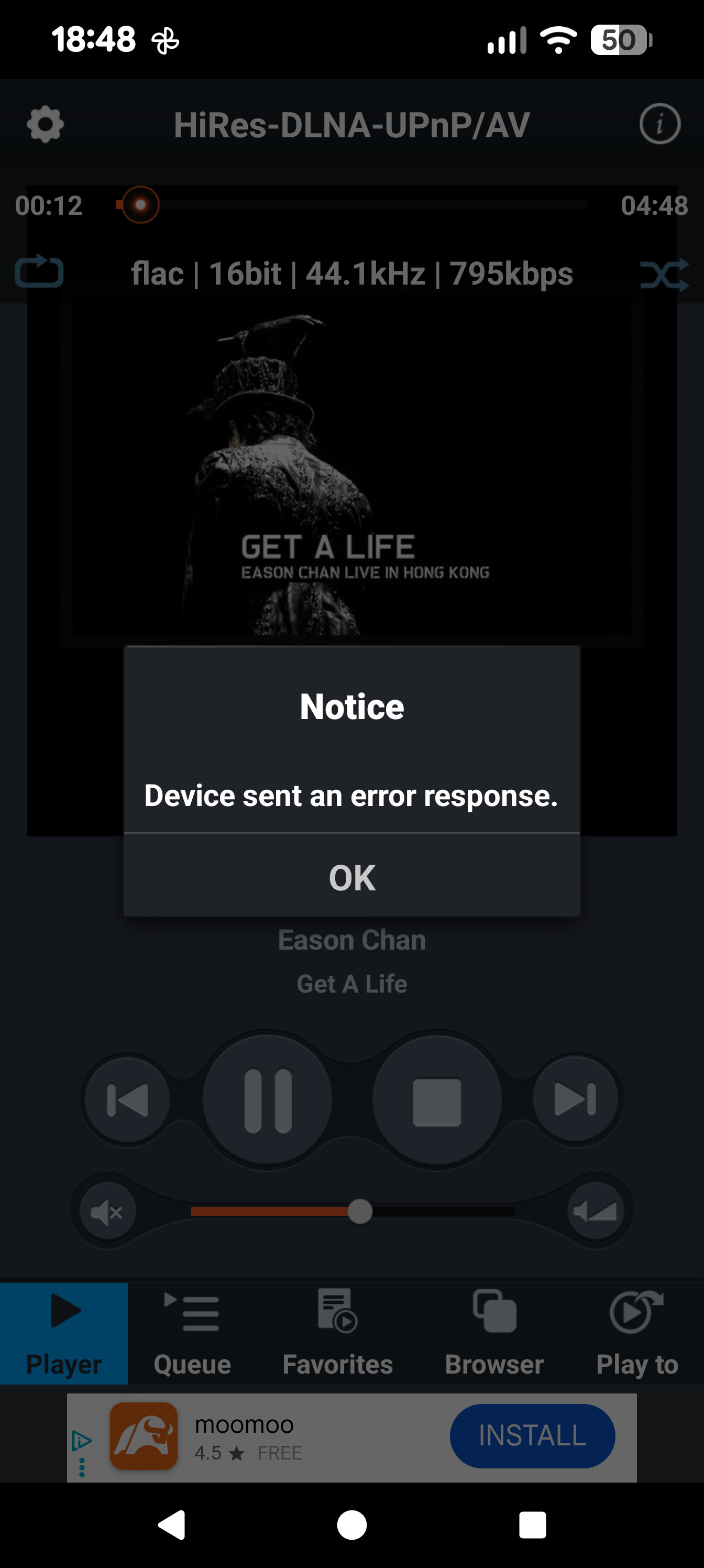

It is me again :), I have been using 2025.10.1 from beta for a few days and I am using mConnect Lite to access Qobuz thru UPnP to play music. From time to time I received a notification from mConnect saying “Device sent an error response.” This notification is very random.
I have submitted a feedback #22fde8f1390afb4f. Could you take a look when you have a minute to see whether that is my problem or not. You have a nice weekend. Many thanks!
Alfred
I see a lot of low-level error(s) during communication with your HAT (Audiophonics).
That causes the device errors.
