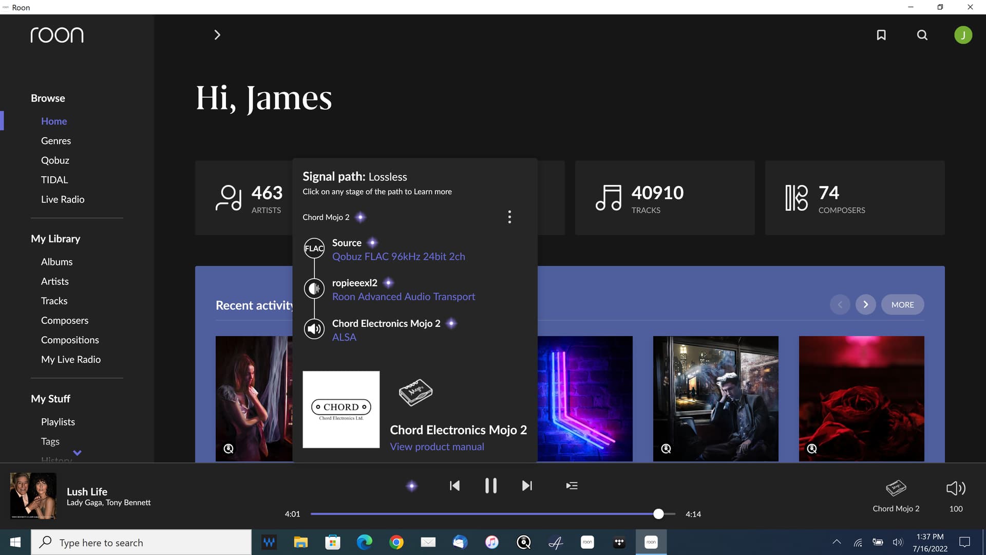

I’m now testing my “away from home” unit running Roon core on my Dell laptop connected to my iPhone 13 Pro Max 5G hotspot. The RPi4 is connected by WIFI to my Dell hotspot which is just an extension of the iPhone hotspot. Output from the RPi4 is USB to Mojo 2 and Focal Clear headphones.
I’m not sure anyone else is running this setup, but it works great away from home when using different iDevices for hotspot data. There is no need to fool around in the RoPieee program changing WIFI settings, such as iPhone to iPad to iPad2, etc.
This works very well and avoids using USB out of my Dell to the Mojo 2 which proved to be very noisy at resolutions of 96 and 192. There are other ways to do this, of course.
