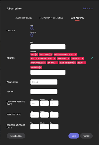

Hi – the title says is all. What I would like to do is select a group of albums, or ALL albums really, and get rid of ALL the genres. I don’t work with genres at all, but rely heavily on tags and since (for some reason) they appear in the same space under the PLAY button in album view, all the genres do for me is clutter the space where I have my tags, which is the information I want to see.
I know that I can batch edit album genres, but only one genre at a time. That is, I would have to pick every genre I want to get rid of individually, which would take forever.
Any help is much appreciated!
You can build up a list of genres to be removed from multiple albums in one operation. That’s the best that can be done. There’s no “nuke every genre” from my albums in one fell swoop AFAIK…

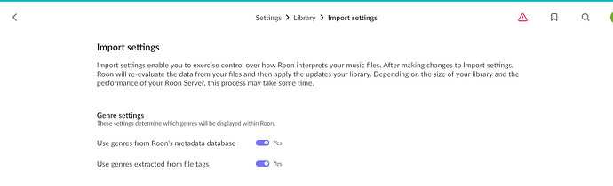

Does anyone know what genre settings do? What does setting both options to “no” do?
It might work… Just trying it now…

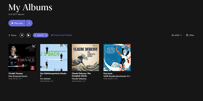

Yes, it almost did (once the changes got applied to the entire library) - no genres visible for 99% of the library. There are a few local albums left showing genres, but these can be chased down via the Album browser and Focus, e.g. for Classical, I’ve still got 4 local albums showing:
Now time to put the genres back…
This is fantastic! It took all night for the library to reload and, as @Geoff_Coupe says, almost all genres are no longer displayed. This is exactly what I wanted. Thank you so very much for taking the time to try it out. Very much appreciated!!

Late reply but this is exactly what I have in Roon for years - both the options disabled.
