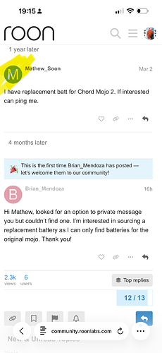

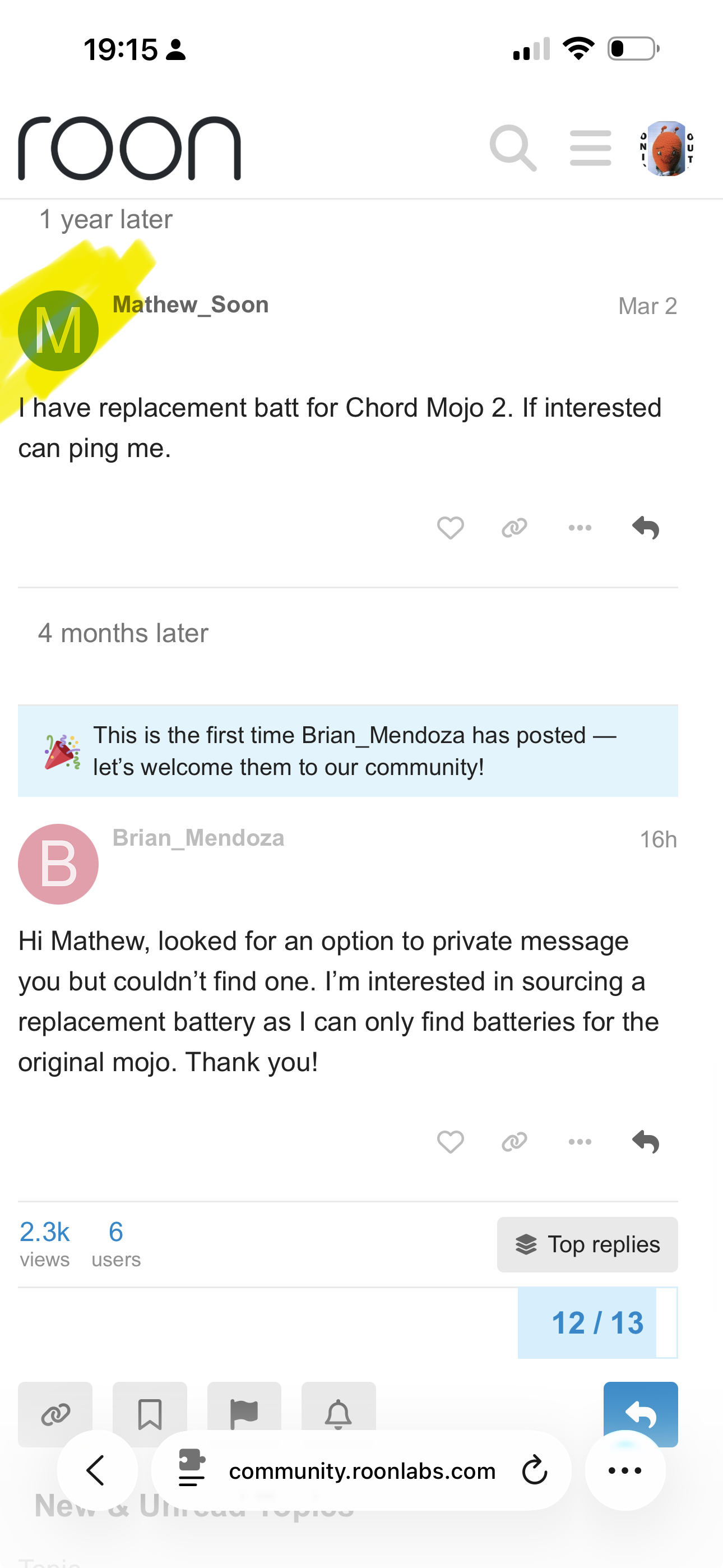

I have replacement batt for Chord Mojo 2. If interested can ping me.
Hi Mathew, looked for an option to private message you but couldn’t find one. I’m interested in sourcing a replacement battery as I can only find batteries for the original mojo. Thank you!

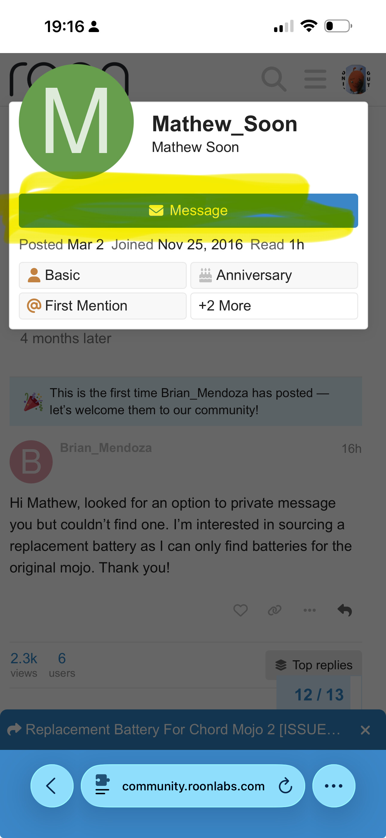

Click Matthew’s user icon or name
Click the Message button
I don’t have that option… maybe I’m too new of a user for messages to be allowed?
Oh yeah, I see that you are a very recent joiner. You need to read for a bit. This should be sufficient (at least this are the defaults of the forum software):
