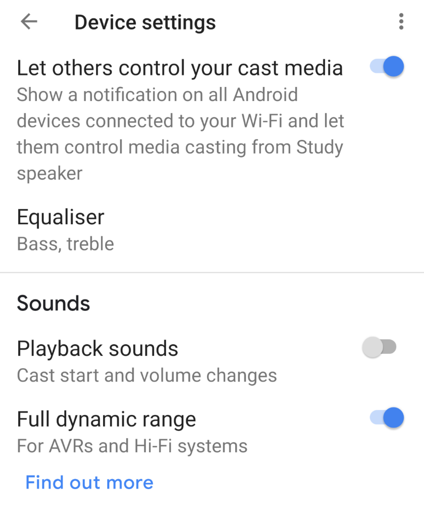

Thanks again Evand…as far as I’m aware I’m streaming direct from my PC to my Chromecast attached to my Bose ST20 with no volume normailisation/attenuation set anywhere within the Roon options but I’ll have another look. Do you know if Chromecast Audio has attenuation built in?
DDJ
It does, use the Google Home app to change the settings - see screenshot re full dynamic range.
Excellent…thanks for that Evand…I’ll have a tinkle around when I get home from work…
