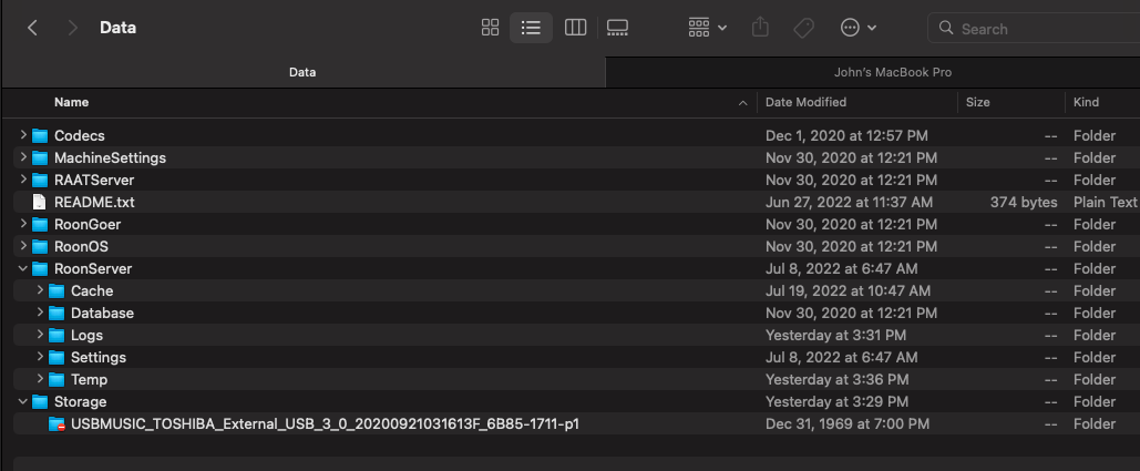

Yes, accessing the drive on my Mac is not issue. Below are screen shots. I can connect to the /data share without issue and browse, but not the USB drive.

That’s an extremely long name for a USB drive. I’d reformat that again as exfat, and by using a name like ‘external’ or ‘usb drive’. Try connecting it again and see if that resolves it.

TOSHIBA External USB 3.0 Media = the “Media Name” of the physical drive which I don’t believe I can change. Although I am attempting to see if I can through the Command Line or on a Win10 machine. The “Volume” name which I can change through formatting is USBMUSIC1.

  • The ROCK OS uses the media name of the drive as opposed to the Volume name (used in the formatting process) and appends a string to it.(see below)
