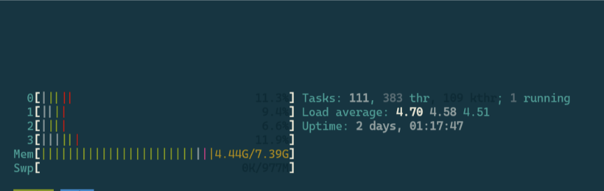

I used to run Roon on a NUC & found the memory usage would creep up until it became unuseable, needing a reboot.
I installed Debian 12 and the server software & it is fine now, I use PEQ, crossfeed, volume levelling & have no issues at all.

Was this ROCK and if so how did you know what memory usage was?

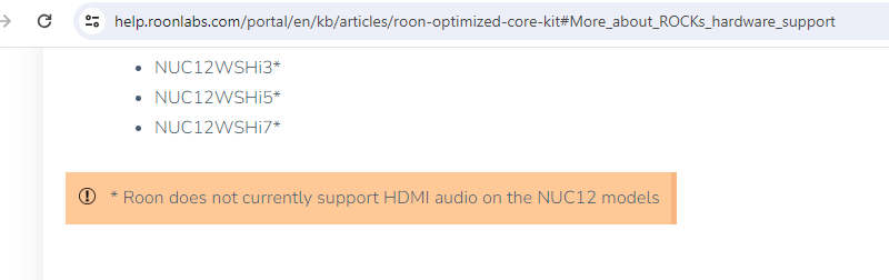

@DSD_Fan , based on Roon’s known issues with the 12th Gen NUC, perhaps you should consider the 11th Gen instead? I realize you’re not using HDMI, but… the 11th Gen has zero playback issues… just a thought.

Yes it was ROCK and I can’t remember how I knew, it might have just been the symptoms of the system, they went away when I installed Debian and ran Roon that way.
