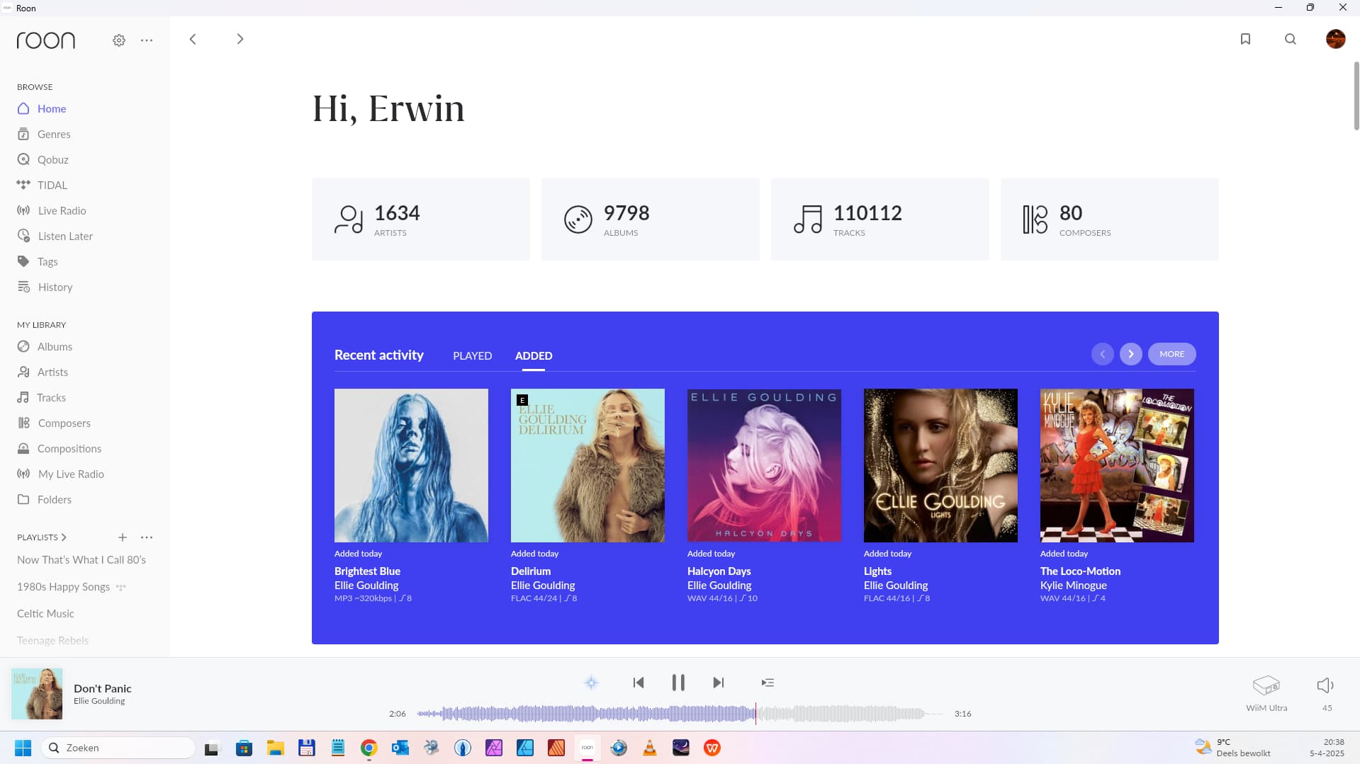

Even though it runs slightly slower my N97 can handle my quite large library. Local, Qobuz and TIDAL.
Wasn’t expecting that. So call me impressed.
