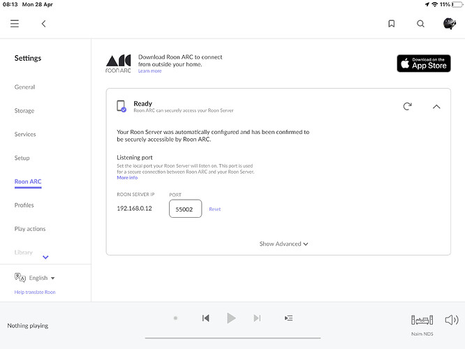

On both versions of Roon OS, you can stop the Roon Server application from listening on port 55000 by setting the Roon ARC port number to 0. On RoonOs 2.1, you can still connect ARC using tailscale when the ARC port is set to 0.

If this is a concern, why not just change the port that ARC uses, away from the default one of 550000.
It is not fixed to this port
Oh bad actors will find any open port. Scans are cheap when you have distributed resources. Mine (my ARC port) was something random for a long time, and I changed it around a few time s, and Unifi IPS was frequently warning and blocking. Teleport VPN ftw.

  1. I am closing port 55000 on my router as its just another small nuisance and unnecessary risk (all be it small).
  2. with the port closed I will use my own Wireguard VPN (which I need for other purposes) to pierce my firewall. In my case its free with my Ubiquiti UDM gateway - ARC ran fine with Wiregard VPN and I will modify my IOS shortcut to turn on the VPN when I connect to my car where I use ARC. Tests out fine.
