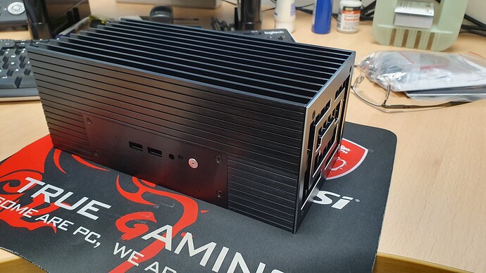

Does your NUC have space for an extra drive internally? If you have a NUC model type of the form NUC8i5BNH, then you do, but if it is of the form NUC8i5BNK, then you don’t.

Thanks Geoff, my nuc is housed in a fanless Akasa Turing case. The guy I bought it from wasn’t sure but thought that may mean that your question about which version may not apply given the way it is currently housed. Any thoughts on that? Thanks
Simon
Thanks Simon. The Akasa case does have space inside to fit a 2.5" HDD or SSD. I’m not sure how thick the drive can be - in the Intel NUC BNH housing, I think there is a limit of 9mm. This means that HDDs of up to 2TB capacity or SSDs up to 8TB can be fitted internally. Akasa installation document is here:

I have that case and it is perfect for a 2TB drive but not for the thicker 4TB model which of course I wanted to use (but thankfully I had both).
It was quite difficult at the time to see where it fitted in the case, but it’s actually a clever design and fits right into the top using some of the additional bits that were left over.
It’s a very well designed case and I have been 100% happy with my purchase decision.

Simon from memory it’s just a few screws to remove, but you need the braces to hold the bare drive in place, if you still have them.
But if you struggle with that, you can always buy a small usb drive and sit that on top of the Akasa case.

Btw…I have the same fanless case with the same NUC. I have a 2TB 2.5" SSD mounted. Works great.
