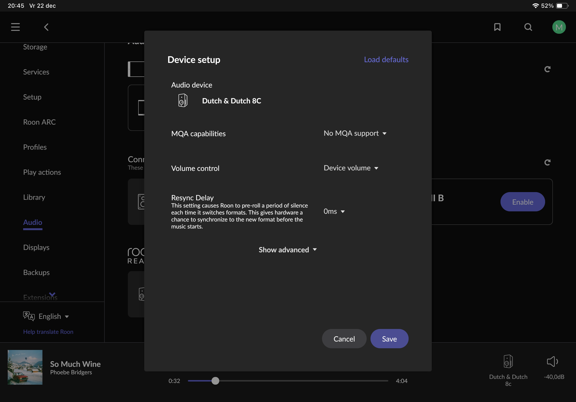

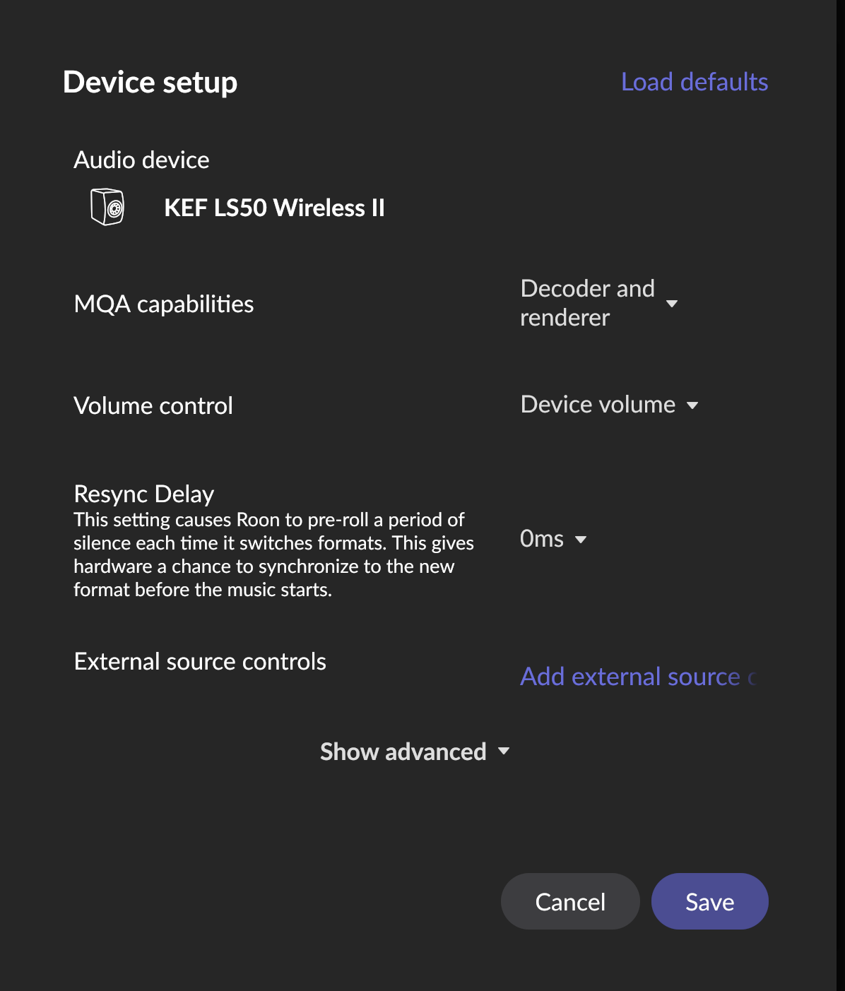

Can you post a picture of your Dutch and Dutch 8C volume settings. For reference here is mine for my LS50s controlled by rooDial. I don’t have D&D 8Cs - I WISH! :slight_smile:
Also note, for some reason you sometimes have to hit Load defaults to get this to start working. I would also make sure you have the latest firmware on the D&ds.
Sure, please see below (I hope uploading picture works):
Firmware of D&D 8c is up to date. Load Defaults didn’t solve the problem unfortunately.

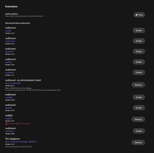

having troubles pairing my surface dial to my pi 4 (actually tried two pi’s). It keeps on pairing forever, but does not ‘connect’. The Roon Extensions are visible in my roon settings. I have tried several times on wifi, ethernet, all does not make a difference (btw the dial pairs with other devices).
Please advise :slight_smile:
Try removing the batteries from the surface dial, reboot pi 4, reinsert batteries & pair the dial.
It may work and is worth a try.
Thank you. Tried it, but no luck so far.
As a last resort, pending further help from Carl, reflash your ssd card and try again, good luck :crossed_fingers:

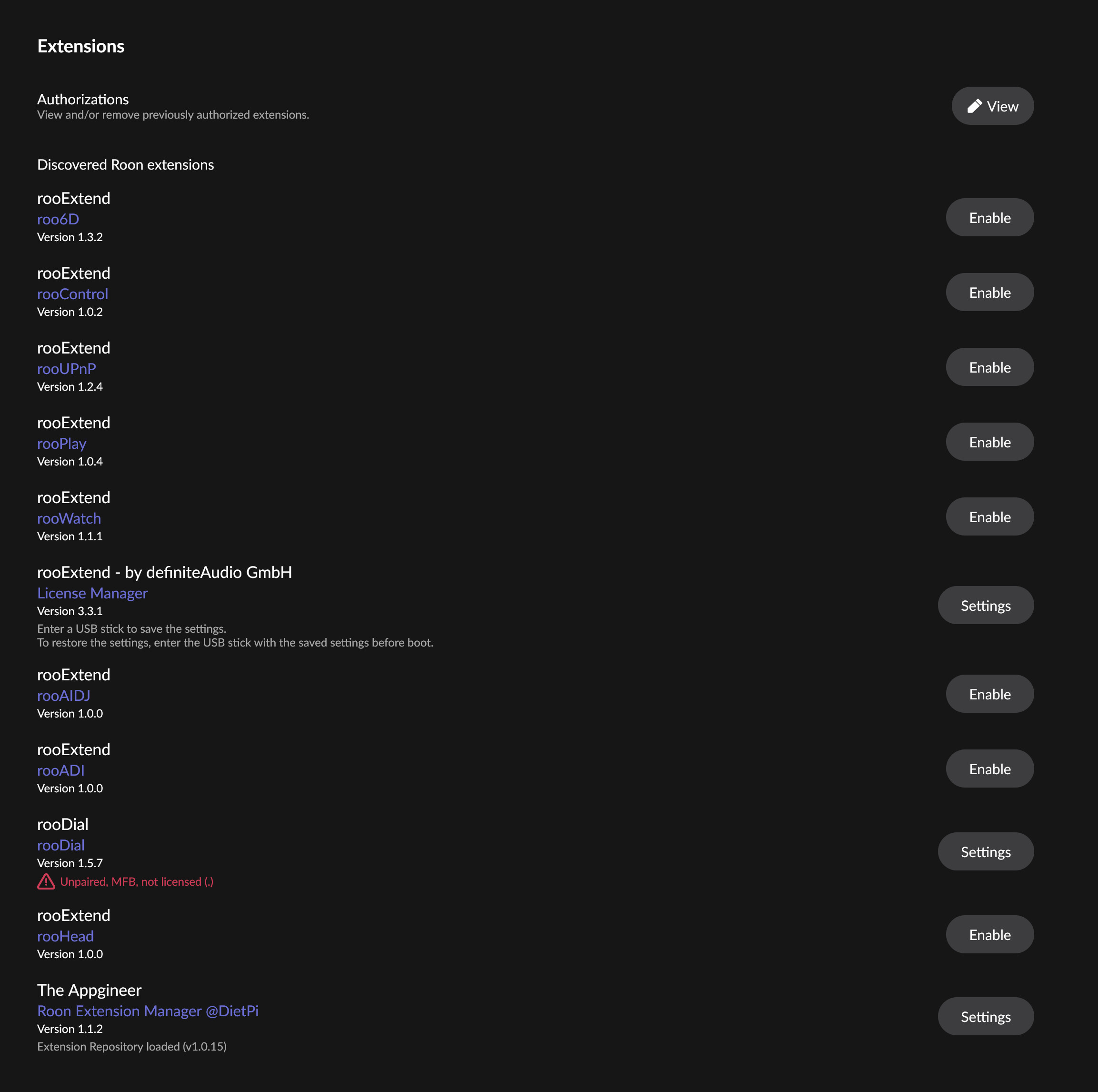

Hi @Poli,
if you use a freshly burnt SD-card v3.3.0
  • you should first get the update to v3.3.1.
  • After that reboot the Pi.
  • Enable rooDial in Roon Settings/Extensions. After enabling or a reboot pairing mode is up for a limited time only
  • Remove Batteries
  • Re-Insert Batteries
  • Press the pairing Button. It should flash 5 to 20 times and then stop flashing. A short time later you should see a the word “paired” in the status line of rooDial in Roon Settings/Extensins.
Please let me know at what stop you get in trouble.
Best DrCWO

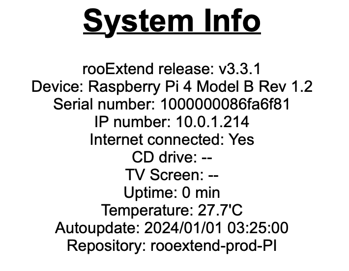

  • Press the pairing Button. It should flash 5 to 20 times and then stop flashing. A short time later you should see a the word “paired” in the status line of rooDial in Roon Settings/Extensins. → not working. The led on the dial keeps on flashing
I have heard there is a batch of Pi model 4 with bluetooth issues. I am wondering if that is the problem…
Below you see the system info as on rooextend.local
Never heared of that :thinking:
Edit: My Pi4 is Rev 1.5
You can try to update the boot loader that also initializes the hardware of the PI. It is available as a SD-Card image.
You also can try with the external BT antenna from ZEXMTE. I always recommend that as it increases the distance between Dial and Pi.
