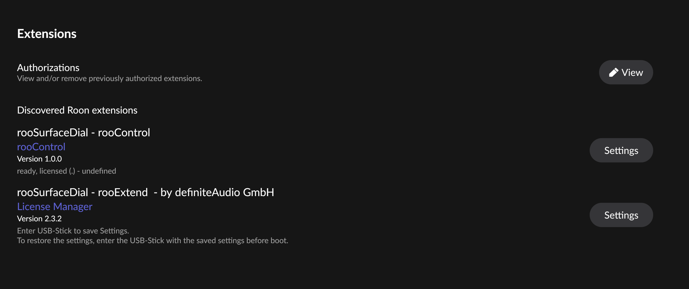

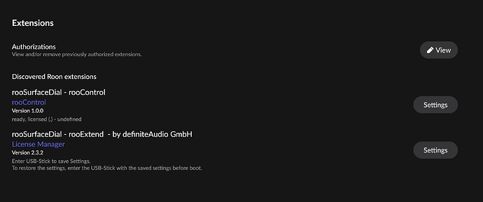

I wish your main page for rooDial had said Zero 2W. I bought a Zero W, case, power supply and Micro SD card off of PiShop.us. Anyway, I bought the lifelong license, was able to flash the older image to the SD card (figured out the hard way as it wasn’t booting up the new image). I’m to the point where I’m in the extension manager in Roon (Nucleus) and I can’t get it to pair to BT. I’ve attached a pic.
Pi Zero W is a bargain and absolutely fine using rooDial. You can’t do one of the advanced things with it but as a cheap device for rooDial it is absolutely sufficient. Anyway thanks’ for the hint I will update the page

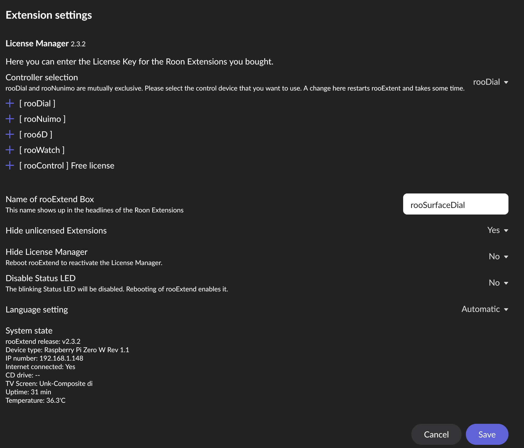

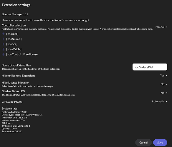

Seems you haven’t entered your License Key in the rooExtend License Manager as rooDial did not show up.
Edit:
You must Click the blue “+” in front of rooDial in the License Manager settings and copy the license key in there. Also in my download area there is the quick installation guide and a Manual (for rooExtend-Box but software is the same) that probably will answer your questions.
Best DrCWO
I did copy and paste it in. I’m going to reboot the Pi Zero W to see what happens next.
After copying in rooDial should show up. Maybe the license server of Sellcodes is down for maintenance. this sometimes happens. Please retry some hours later…

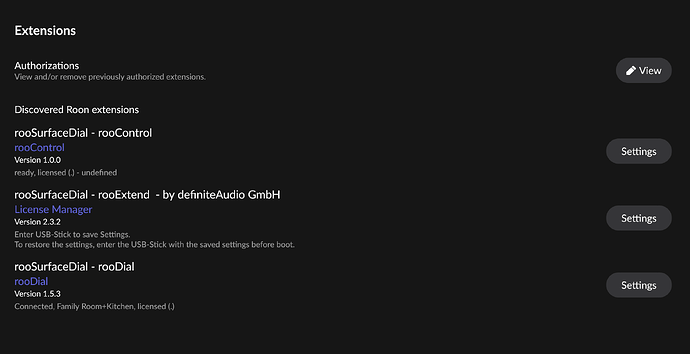

Here’s what it looks like now. I seem to have more extensions showing up in this screen. It’s working. Do I need to go into Roon Extensions if I want to change the zone? For example, right now it’s a group Family Room (which are Alpha IQs) and Kitchen (Pulse 2i). If I ungroup it, where are the expected actions? Seems to be working in the current group. Neat little project.
Yes.
Playback zone is configured in setttings. You can also choose Zone Follows Playback and if you want to control volume for other non roon sources. Set “Change volume at playback only” = NO.
