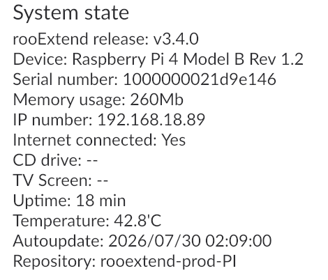

Many thanks for that; after unplugging the RPi4 for a few minutes (& therefore no Extensions showing within Roon / Settings / Extensions), I then powered up the RPi4; watching the Extensions page
  • the rooExtend Manager appears first - checks the license, then checks for a USB stick (which correctly it doesn’t find one)
  • then the rooControl and rooDial load; the rooControl says “selected”, but the rooDial says “Unpaired, LSX” (the “zone” I want to control within Roon is some KEF LSX speakers)
These 3 extensions stay showing for maybe 30 seconds, then they drop off the page, no Extensions show. After another 30 seconds the 3 Extensions re-load, and the cycle repeats. Whether I press the Dial pairing button seems to make no difference to the cyclical loading / unloading.
Do you know what I may have done wrong to cause this cycling?
TIA
This is not normal at all.
Please find the IP of your rooExtend at the end of the License Manager setting page, open the browser and enter http://[your IP]
This only works if rooExtend is active!
Find the button to show the system log and mail it to me to info@definiteAudio.de
I will analyse
Best DrCWO
