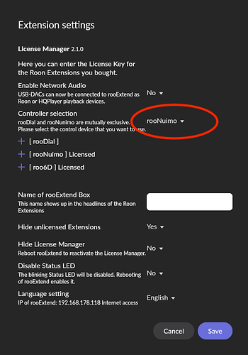

I upgraded to 2.1.0 this morning. Just built my Rasberry Pi4b yesterday and can connect with rooextend.local, however I can’t get the Nuimo to connect via Bluetooth. I have tried connecting by using a TP-Link USB Bluetooth Adapter for PC(UB400) adapter as well as removing the TP-Link adapter and seeing if it would connect with the Raspberry Pi’s built in Bluetooth. No luck.
I powered off the Pi several times as well as the Nuimo with no luck. Still have the blinking Bluetooth icon on the Nuimo. The Raspberry Pi is connected via Ethernet.
Can you help?
Stephen,

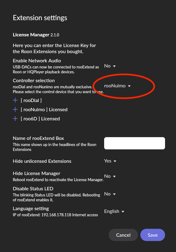

Did you select rooNuimo in “Controller selection” of rooExtend Settings (see screenshot)?
If so, do you see the rooNuimo Extension in the Roon Extensions Settings?
If so, does the rooNuimo extension prompt “licensed”?

Not sure what happened. Restarted with license key in the Pi and I got the menu shown above in Roon. Working great now!

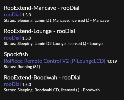

I upgraded my Pi Zero W with the new version yesterday.
However I still have issues with waking up my Microsoft Surface Dial from Sleep. Even after the upgrade, the Dial is not able to connect (status shows Sleeping). This is after say 12 hrs after last listening / use when it was working perfectly.
Do I need to reboot the PiZero every time as this is the only way it connects. All extensions in Roon are showing enabled.
I find all of my Dial’s (I have 3) normally wake up after a single press usually then I can press again and they start play etc.
Grab 2021-11-15 at  19.40.44

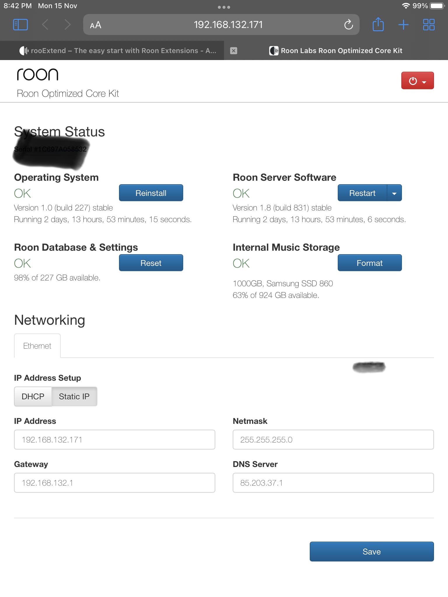

Did you shot down the Roon Core in-between?
It’s always on . It’s a Roon Rock on Intel Nuc 8i7 in fanless case and always running I last used this morning 8 hrs ago and on return no joy. Will not connect. Only connected on rebooting the Pi Zero
