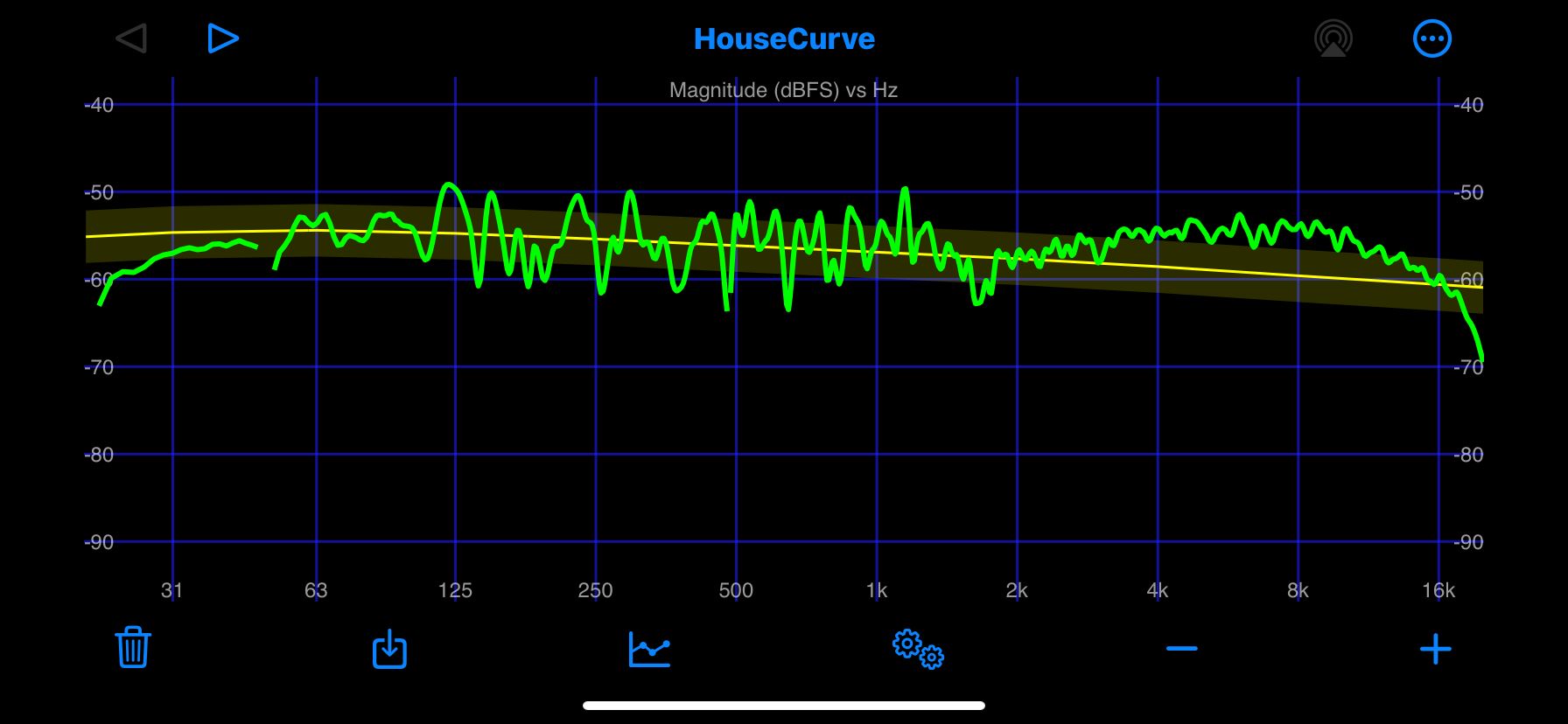

hi. so I purchased housecurve , made the measurements with the file for Roon. played the file with Roon and measured them with a iPad Pro (m2).
but before I mess up my loudspeakers with some crazy boost or something I thought its better to post the screenshot here, maybe someone could take a look if its alright.
I applied -6db headroom in room. Loudspeakers are the wharfedale super Linton, harman target curve
Apparently I was just wrong… The bass got so strong that I had to turn the gain down a couple of notches. Thanks!

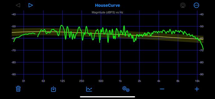

Downloaded this app a few days ago…did some reading on how to use it…
This must be the simpliest way to get room correction into Roon…
Love it so far…
I’m not so sure about those rather narrow band high gain bass boosts to make up for destructive interference problems, which can’t be corrected for, actually.
To see what I’m talking about, take actual measurements with the correction in place to verify the predicted response!
Maybe also try to set the target curve below those dips‘ minima if you’ve got enough gain in your amplification stage to make up for that, or not correcting the affected bass region instead, and listen to the effects in comparison.
Thanks for your input…
This is the first quick and dirty attemp…
I will explore any further options to fine tune it…
Btw…it sounds cleaner in the lower frequenties now.

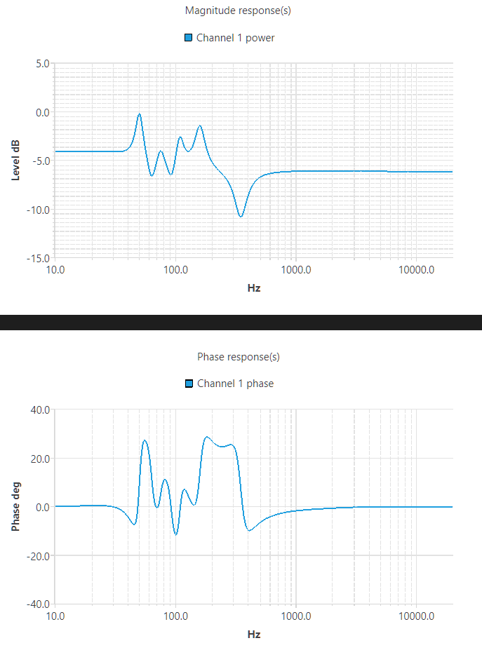

It took a month of practice to get the desired result… In the pictures, all PEQs were converted to convolution with HQP. A couple of runes had to be added to the matrix (iir:type=lshelf;f=50;g=2,iir:type=hshelf;f=4000;g=-0.1). UMIK-1 and AudioTools were also used. The top end is a bit overshooting, but the intention was to match the bass and main speakers together (35-400hz). And I succeeded well in that. Of course, Anti-mode was also used.
Genelec G4 and Klipsch R-121SW with Anti-mode
