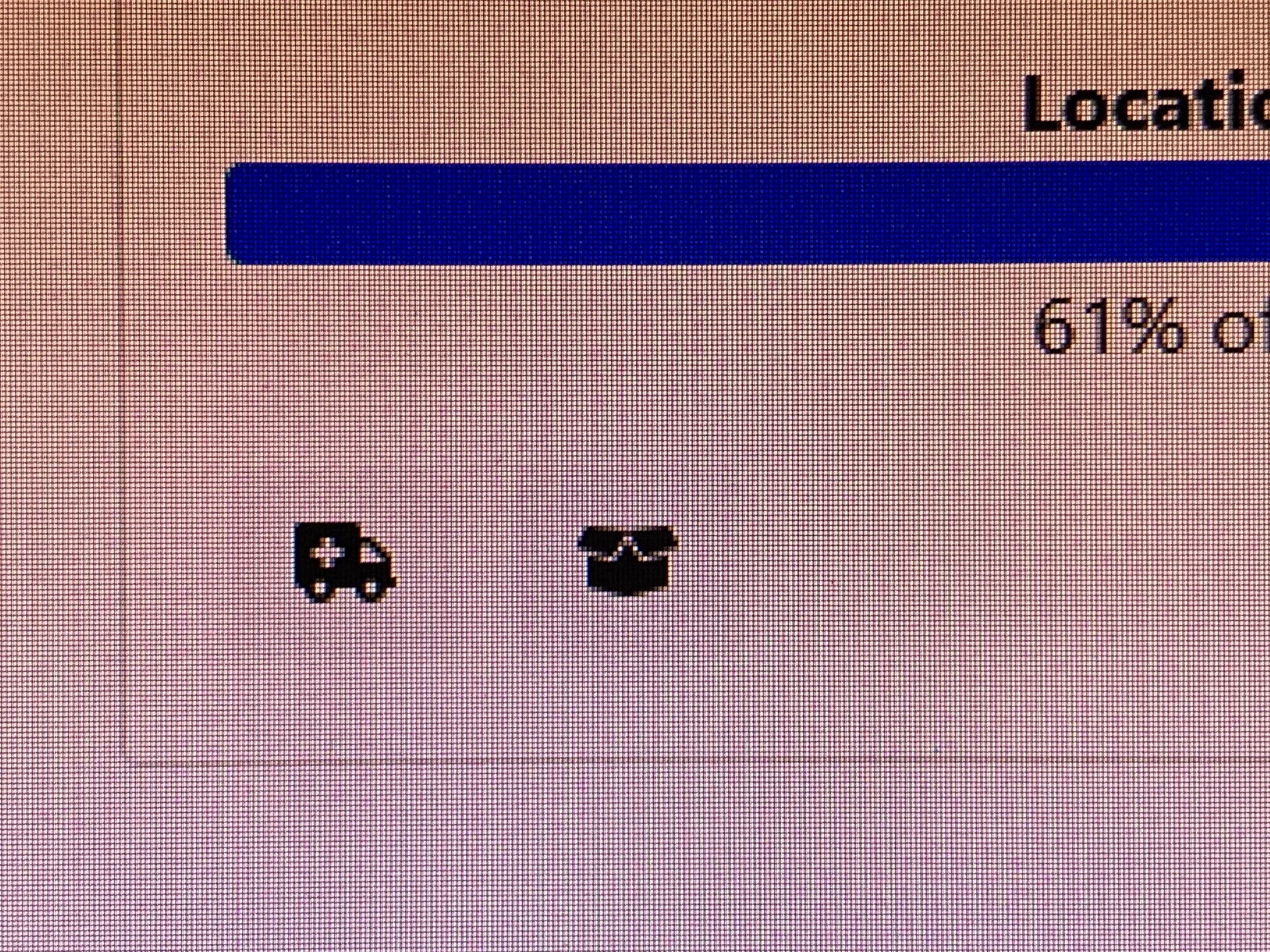

Easy fix:
Log into your QNAP NAS. Go into apps and find Roon Server. Open it. Click on the little “box” icon in the bottom left and tell it to get/update Roon Core to latest version from Roon. Done.
This worked for me! Thanks.
Hi Shane_White, I’ve tried to click on the “box” icon but got stuck into this page. is there anything I am missing?

Hi All, I have a similar issue. I tried to update roon core in my QNAP TS 251+ with 8MB ram and I’m stuck in this window asking to set up the location for the roon data base. I assign the righ folder as usual and nothing happens… I have tried different folders, reinstall several times but it does not go beyond this screen:

The Roon Server webpanel checks the hostname in order to use QNAP FileStation API. I have not tested this with myqnapcloud, as I assumed, myqnapcloud will mostly be used as a service to access the qnap over internet…
I had that message too…and I proceeded. Mine did as advertised and stopped my Roon Server and then upgraded itself. I then re-opened the app and it showed the updated version.

Thanks a lot @crieke for your help. By entering in the OS of the NAS through the IP address instead of through myqnapcloud it immediately worked perfectly !!!
