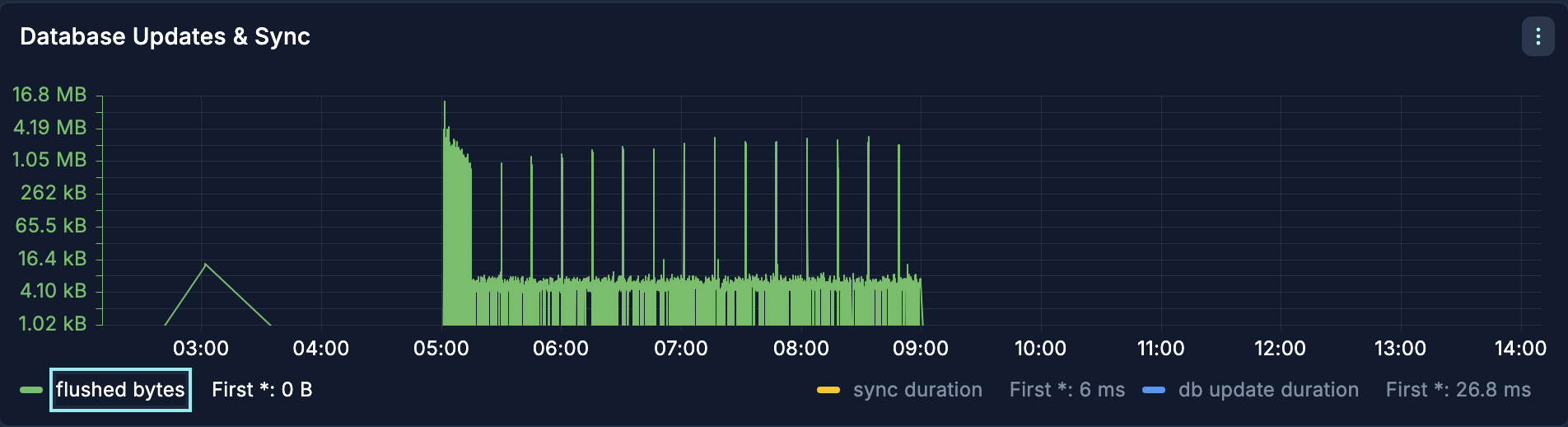

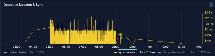

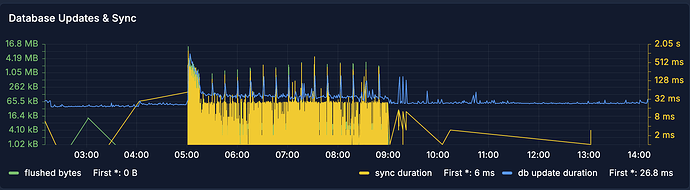

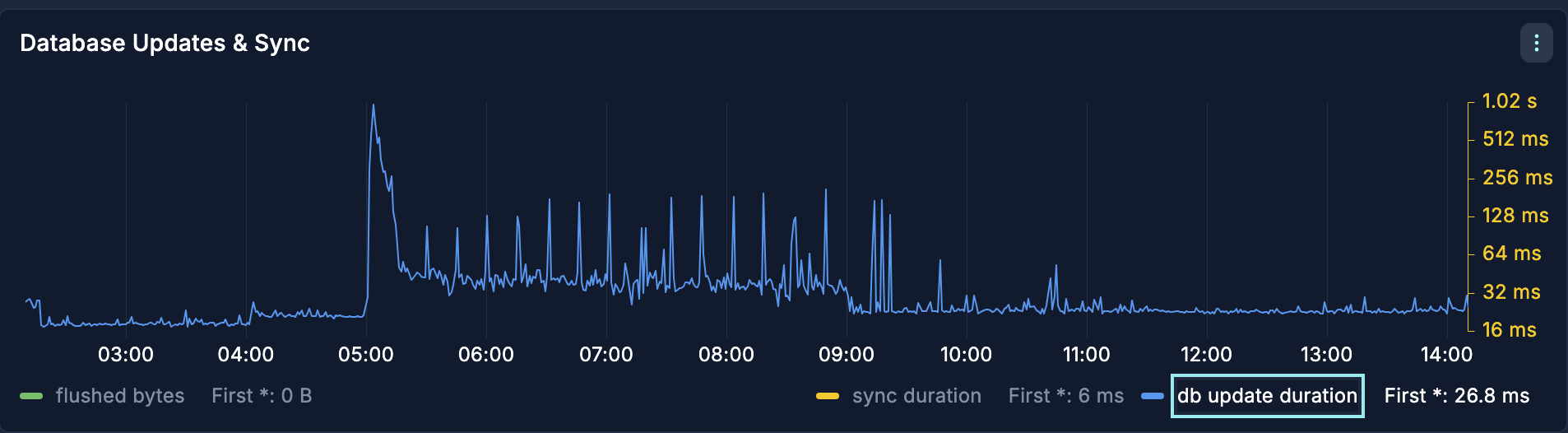

This is an interesting correlation, but audio device disconnects do not cause database churn. It’s the other way around - lengthy GC pauses on the Roon server can and will cause network disconnects. See the following analysis for my take on the situation.
Claude’s advice below is flawed and if followed, the actions will be ineffective or meaningless when it comes to database (music metadata) updates.
The metadata queue will resolve itself over many hours or days :frowning:
How long database mutations can take
Size of flushing memory data tables to disk in megabytes
How long it takes to write the data to disk
Overall picture of Roon server running scheduled maintenance job maintaining the music library
These activities were not caused by audio device disconnects from Roon server.
