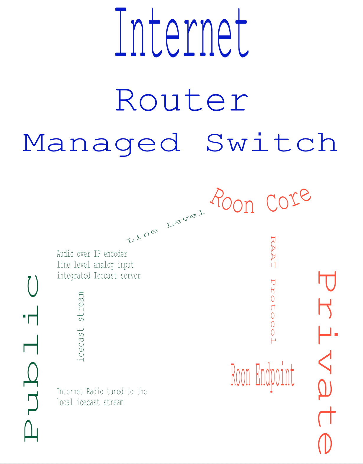

A simpler solution possibly, I use this
Public and private VLAN.
IP encoders on the public side. Broadcasts stream on public VLAN. Sonos plays radio stream. Music playlist controlled on Roon core on private side.
Okay so you did give your roon core 2 network interfaces, right? How did you manage to spread split services? Simply with firewall/port blocking or is there a config file for roon core somewhere?
No.There is no additional network configuration required on the Roon core. One ethernet connection to the managed switch.
The only connection between roon core and the public side is line level output to the audio IP encoder which sits on the public side.
I have added the network components to the picture.
Managed switch and router configuration (layer 2/3 network engineering skill) is assumed.

Forget about networks for a moment and focus on the meaning of line level, audio IP encoder and icecast stream.
I have updated the diagram based on your questions.
