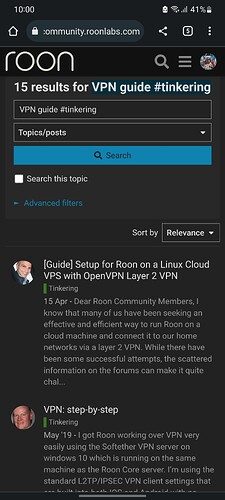

Can I somewhere find a guide how to configure Roon with vpn?
Look in the tinkering section. VPN isn’t supported by Roon.
The above might be helpful. Keep in mind that you cannot be using Rock or a Nucleus as a core as you have to setup the VPN on the Core machine. I just noticed that you are using a QNAP as a core, so there maybe a Tailscale QNAP app.
You can use ROCK as a core. Probably Nucleus as well. The instructions cover that. You do need to run Tailscale on a different machine though, you can’t run it on the ROCK or Nucleus for obvious reasons.
