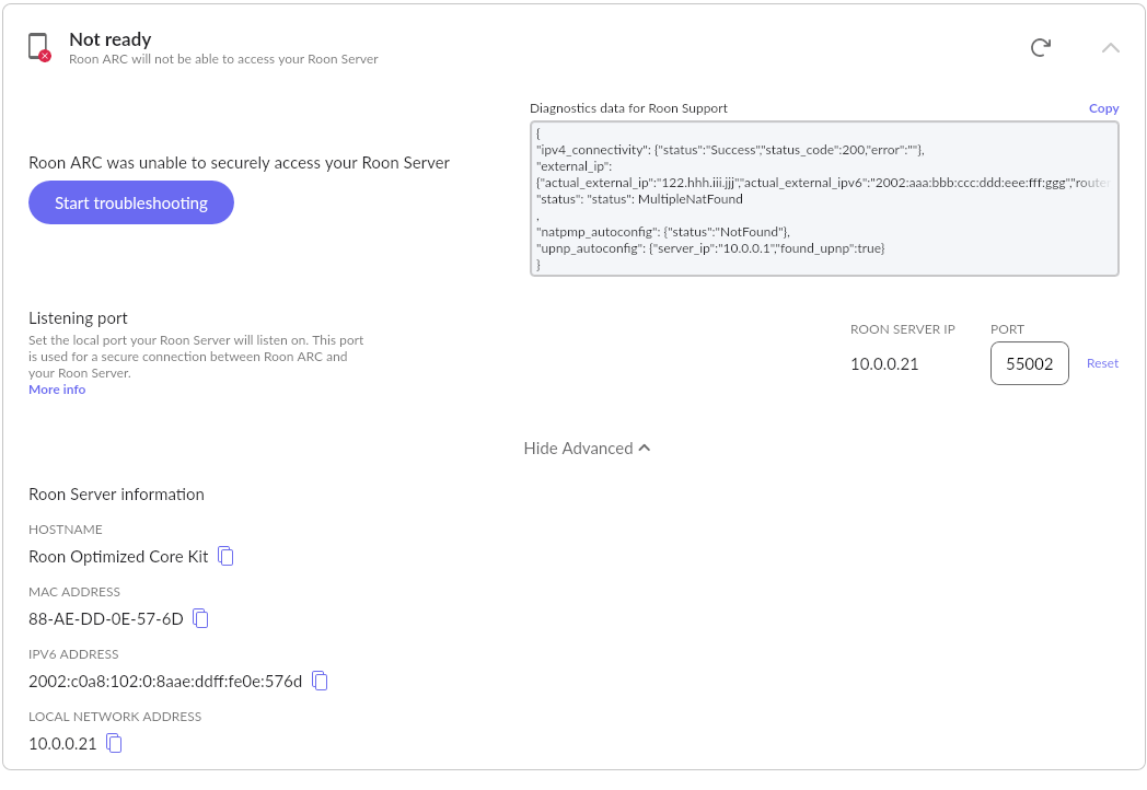

Roon Arc not connecting
My Internet Router is ZTE F670LV9.0
I have connected it to my Netgear Orbi Mesh 750 system.
The Local Network is on 10.0.0.2 - 10.0.0.100.
The ZTE modem / Orbi Mesh system is in 192.168.1.XX IP address system
The Rock is on an Intel NUC11PAHi330ZO. The rock address is 10.0.0.21 connected by ethernet to the Orbi mesh
The Internet service provider in India is Airtel
I have got static IP enabled to enable opening of the ports
I am unable to configure port forwarding on the ZTE modem. However the Orbi Router has opened the relevant port and the issue is with the ZTE modem connected to the Internet.
If I enable DMZ setting on the ZTE router, Roon ARC is working well.
Can you please advise how the router is to be configured so as not to use DMZ

You have two routers both of which are performing NAT. However, because you state that it all works when you use the DMZ option on the ZTE router (presumably putting the Orbi router into the DMZ), we can be sure that your ISP is not using CG-NAT which is good.
You are using uPnP to configure a port forwarding rule on the Orbi Router but this is unable to automatically configure the required port forwarding on the ZTE router.
Instead you will need to configure port forwarding on the ZTE router manually - and forward the ARC port (55002) to the WAN side address of the Orbi Router (which will be a 192.168.1.x address). You may also find that the Roon ARC connectivity test continues to report an issue because your ISP supplied ip address (the one represented by 122.hhh.iii.jjj in the diagnostic text) does not match the WAN side address of the Orbi Router to which the Roon Server is connected.
Alternatively, as a preferred solution, you could just configure the Orbi router in ‘Access Point’ mode so that it does not perform Network Address Translation (NAT). See:
Then you will have elliminated the MultipleNatFound issue and the only port forwarding required will be on the ZTE router (which can be done either manually or automatically by using uPnP).
Note: If you change the Orbi router to Access Point mode, you will need to force all connected devices to get a new ip address from the ZTE router (in the 192.168.1.x subnet). This may require you to power cycle some devices.
Finally, whilst using a DMZ to solve ARC port forwarding is frowned upon because of the severe security issues associated with putting a non-firewall device in a DMZ, in your case, putting the Orbi Router, and only the Orbi Router, in the DMZ on the ZTE is not such a security risk because the Orbi Router itself isolates the rest of your network from any attacks and provides the security that a DMZ normally circumvents. However, you should only consider this option if you have no other devices connected to the ZTE router and the ZTE router’s WiFi is disabled because the use of the DMZ would mean that a DOS attack could still interfere with the operation of other devices connected to the ZTE router. This would effectively mean that all security aspects were handed off to the Orbi router to handle - but the Orbi router security should not be any worse than that of the ZTE router.
