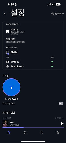

I’ve been using Roon arc through iOS and it works perfectly outside of my home network like below.

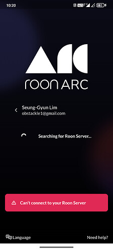

Recently I added a new Android device (Moondrop MIAD01 to be exact, a cheap Chinese Android phone/DAP) only to find out my Roon ARC (Android) app can’t connect to Roon server outside. It does connect and work well only both when I’m at home and (home) wi-fi connected. If I went outside, it suddenly stop to connect.
ARC Connection Status saying “Port Forwarding Issue: Check the ARC settings on your Roon Server” while it can’t be a issue because at the very same time my iPhone’s Roon ARC works very well.
I have delete and re-install Roon ARC on Android several times. Didn’t help anything.

Below is screenshot of my Android device. The exact date and time is 26th February 2025, 09:54 AM in Japan/Korea Standard Time zone (UCT+9:00). My location is Seoul, South Korea.
And this one is from my iOS device which connected well onto Roon server only 1 minutes after (9:55 AM)

On a separate note, the two screenshots display different builds of ARC - it doesn’t look like the iPhone is updated to the latest available build, 1.63. Please update so we can perform a clean A/B test.

I did re-install ARC several times like I mentioned previous post but it hadn’t solved the issue. I gave another try this time, it shows these four status again and again.
Thank you for an advice. I’ve updated ARC on iPhone to latest build, works great on iOS as always.
