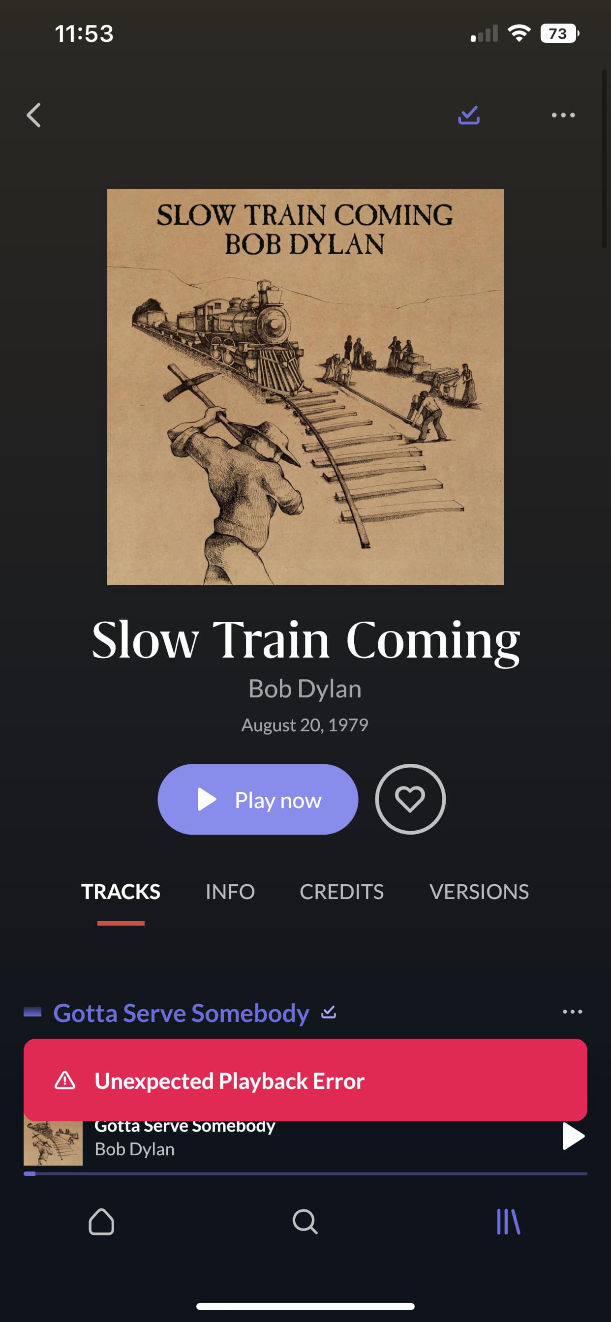

I can play DSD files from my phone to my Mojo 2 with no issues.
Doing the same from Roon ARC gives “An Unexpected Error Occurred”
I’m assuming this should work?
I can reproduce that error if I use Convert to PCM as the DSD Playback Strategy. I use DSD over PCM instead.
Try the DSD over PCM v1.0(DoP) setting.
That worked, cheers
I still get that error even when I change it to DSD over PCMv1.0 (DoP)
