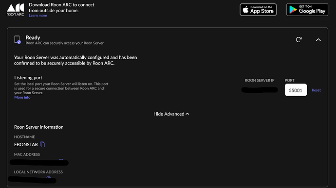

ARC Status
Roon Arc can securely access your Roon Server
Roon Error Code
None on server.
Roon Arc clients (2)
Both Android - one connecting via T-Mobile, the other via AT&T
Arc clients will both connect and allow server to be selected.

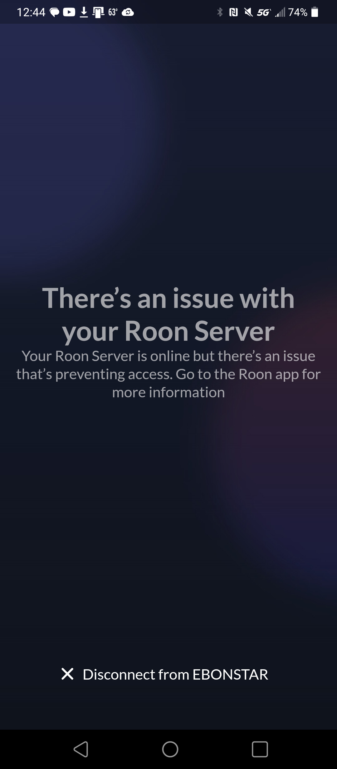

Shows “Syncing with Roon Server for first time”
Brings “Who’s listening” with my 2 profiles
When either is selected get the following error:
“There’s an issue with your Roon Server. Your Roon Server is online but there is an issue that’s preventing access. Go to the Roon app for more information”
ISP Google Fiber
TP-LINK AXE5400 Tri-Band Wi-Fi 6E Router
Port forwarding is established using Port 55000. Tried changing all settings, including server, to 55001. Same issue
