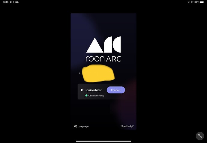

I went on holiday three weeks ago, and already after two days my core was unreachable with ARC. Luckily, I have a lot of music downloaded to my phone (Android), which I can play in offline mode.
I experimented with ARC on my iPad: after resetting ARC there, and even after deleting the app and reinstalling, I get the message that my core is ready, but after clicking connect, there is an endlessly spinning circle. I have tried to connect multiple times over several days, over different connections in different countries (Italy, France, Germany, Switzerland, The Netherlands, using my phone’s hotspot (5G and 4G by Odido, formerly T Mobile) and Wifi that was offered in different holiday homes).

Thanks for your report. It could be a similar issue to the others mentioned here in thread. Simply reinstalling the app won’t work in that case as the Core is crashed and needs rebooting. That is the only short-term fix others and I were able to find.
