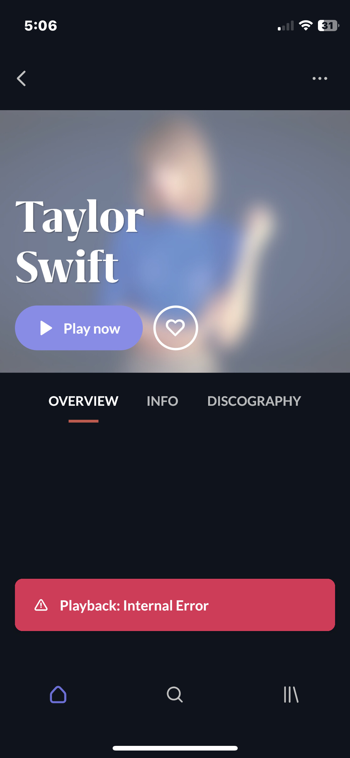

Roon Arc was one of those apps. After downloading the replacement app and connecting to Roon core, I was getting (and continue to get) this message in the Roon Arc tab:
I am able to connect to Roon Arc in my home using Wifi but unable to do so once I shut WiFi off in order to replicate outdoor use. Here is what I now see:
with the horizontal blue line scrolling on the screen from left to right, and then:
Roon Arc worked fine for me on my old iPhone. Any thoughts what might be going on?

I’m happy to report that I solved the problem after spending a hour or so with Google WiFi support. After rebooting my network and devices, I later realized that I previously changed my NAS password and neglected to update the new password in Roon so Roon could access my music library.
This came to light after rebooting the Roon core and then no longer having access to my library (versus the residual music data in the screenshots above). I then tried to restore. That is when I realized that the Roon core had no access to music library. After adding a network share, I was able to restore my library and then Roon Arc worked fine.
Man, what a rookie error…
