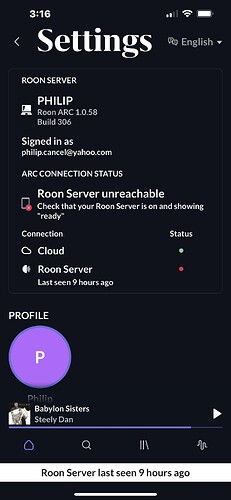

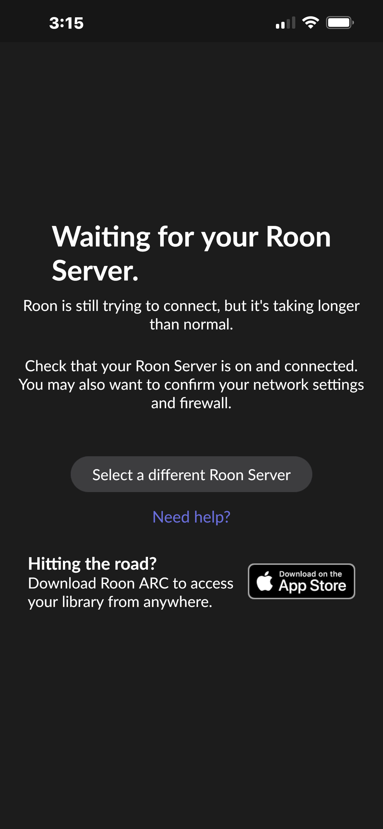

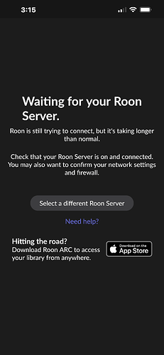

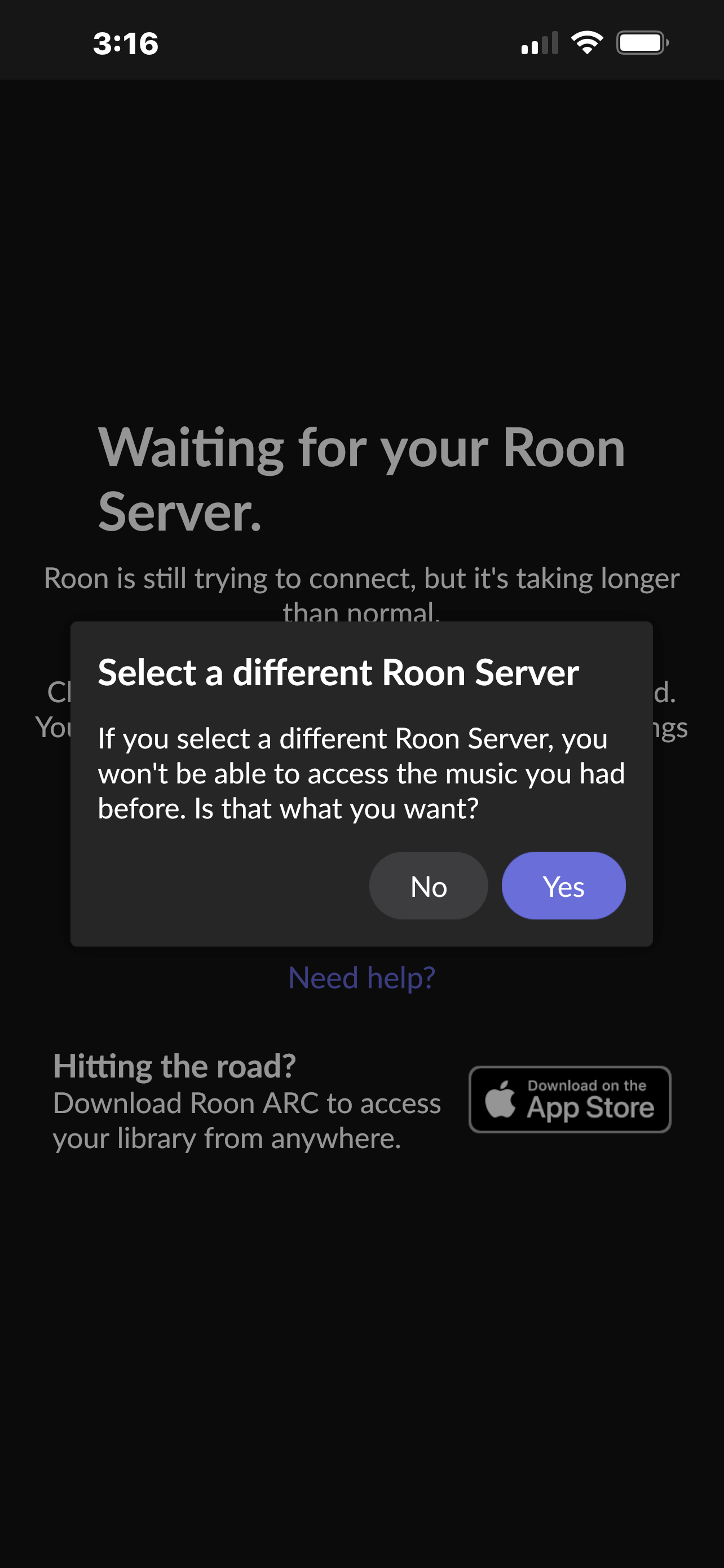

I was down stairs in the kitchen this morning and I’ve attached the first 3 of 5 screenshots from both apps on my cellphone. The last 2 screenshots are my Windows 11 laptop upstairs, of both Roon & Tailscale.

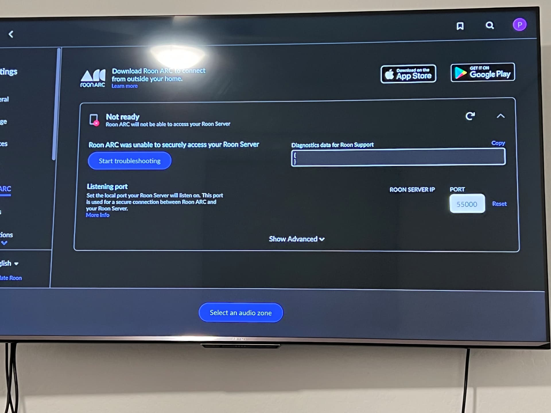

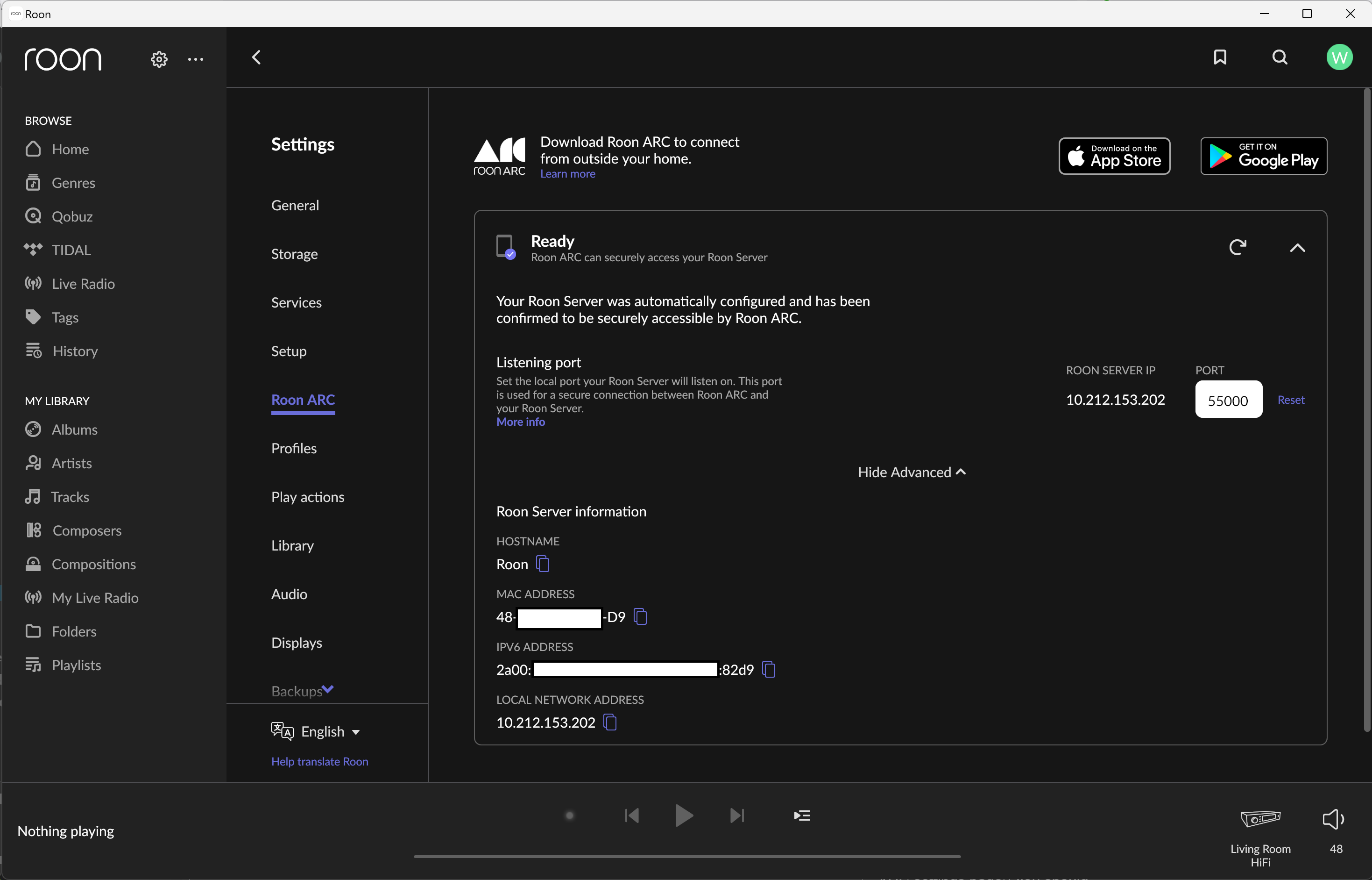

The first thing that I noticed is that the image you have of the Roon ARC settings page on the Desktop Roon Client is not showing a Roon Server ip address and I can see no evidence that you have removed it from the image (there is no point anyway - this is a private ip address).
Not seeing the ip address here is unusual. Have you, by any chance, got a network that is only configured for IPv6. I.e no IPv4 ip addresses are issued to devices?
If you have not got IPv4 available, then port forwarding can not work - and I’m not sure how that would affect tailscale.

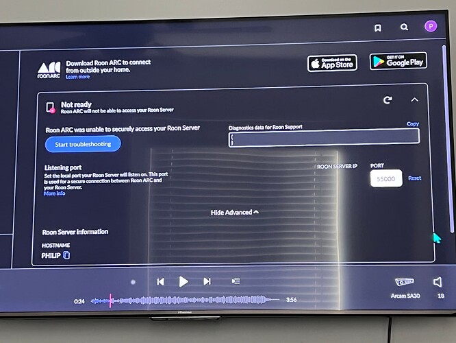

What do you see if you click on the ‘Show Advanced’ text seen at the bottom of your Desktop Roon ARC settings page? You should see some extended server information like (Obviously, my Roon ARC setup is working - and I have obscured my server MAC address and IPv6 address because all IPv6 addresses are public - if you post an image you should do the same):
I don’t know why ARC on your mobile was working when it’s wifi was turned of unless your mobile provider provides IPv6 and you have no IPv6 firewall configured on the gateway router. Additionally there should be no difference between ARC operation with WiFI turned off in the home and remote from home (except that that could be attributed to difference is cellular signal strength and quality).

Hi Wade, I did notice the Roon Server IP was missing to, but I didn’t know why.
When I did click on the “Show Advanced” last night all it had was
HOSTNAME
Philip
Nothing else.

To be honest, I think I have exhausted my ability to help and the best thing is to wait for the official support staff to get involved. They may be able to view the logs (although you may have to extract them manually and send them) in order to find out more about what is going on.

I want to double check the system at home to be sure it’s not suddenly stopping, searching then rebooting with the attached screenshot, in case there is something else I need to get resolved.
