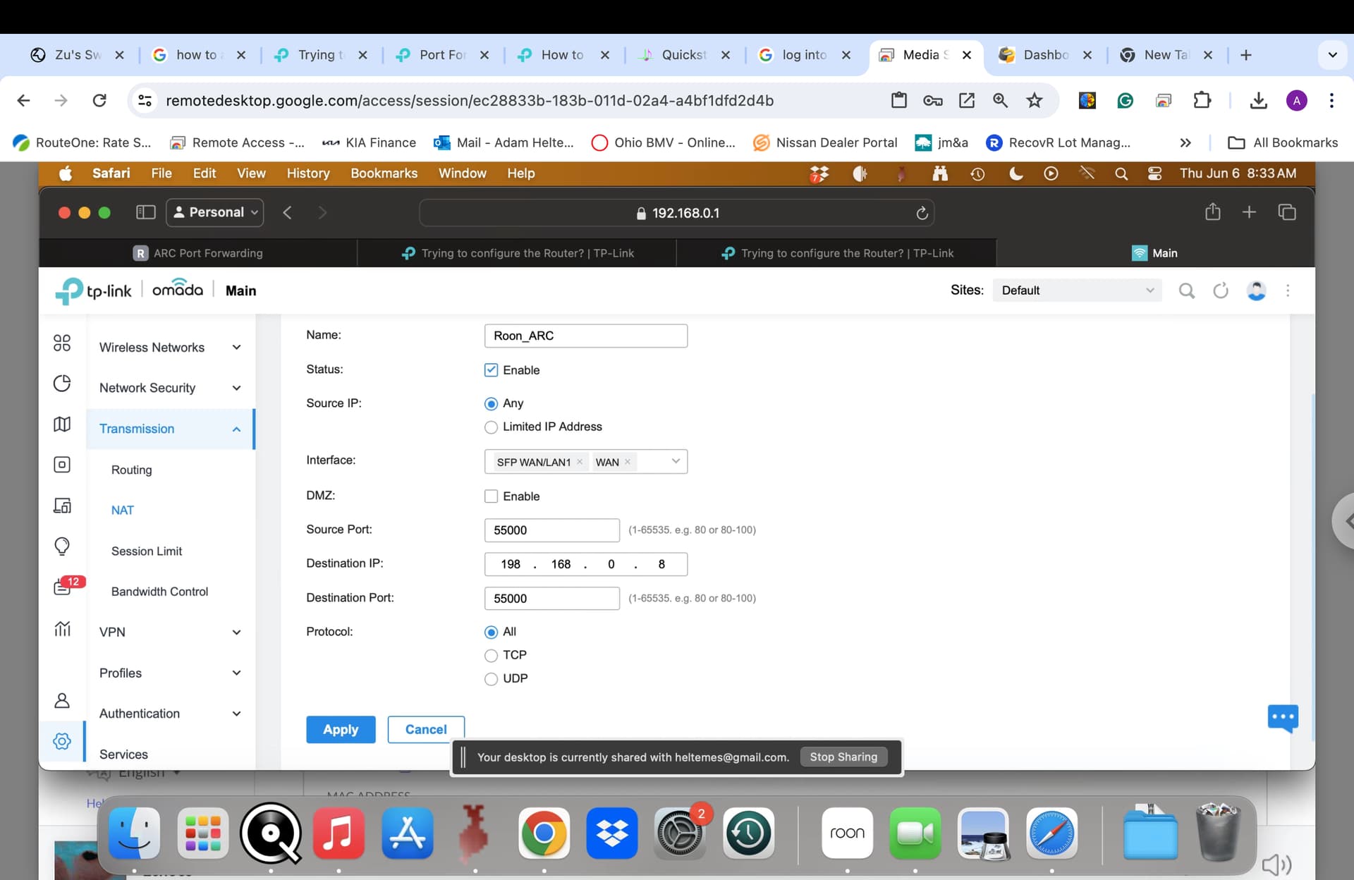

Roon ARC has suddenly stopped working. I checked my port forwarding settings. Everything seems correct. I have the Roon IP set as destination IP and I'm using Port 55000. Both match the settings in Roon. I'm using a tp link wired router (Omada). I also have my firewall turned off. I'm out of ideas. Thank you for your help.
My ISP is Spectrum. I have a tp link wired router (ER7212PC v1.0). They are linked together via Ethernet cables (Audioquest Vodka). Roon/ARC are running on MacOS 14.4.1(Sonoma).
Here is a copy of my port forward settings.

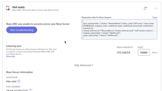

Is there an error message in the box on Roon → Settings → ARC
“ipv4_connectivity”: {“status”:“NetworkError”,“status_code”:504,“error”:“error: Error: ETIMEDOUT, response code: undefined, body: undefined connected? undefined”},
“external_ip”: {“actual_external_ip”:“98.aaa.bbb.ccc”,“actual_external_ipv6”:“null”,“router_external_ip”:“null”},
“upnp_autoconfig”: {“status”:“NotFound”}
Here is a screenshot of my ARC screen
Strange, looking all fine and the error message just complains about UPnP not found. This shouldn’t appear with your manual port forwarding rule, so maybe the error provides confirmation that the manual rule isn’t working.
I can’t see why it would not, all looks fine. Did you reboot everything, starting with the router?

I figured it out! I’m a knucklehead. If you look at the screenshot of my router port rules, I set the IP as 198.168. It should have been 192.168. I’ve been troubleshooting in the back seat of a Telluride (remote-in) coming home from vacation. I completely mistyped it.
Thank you for jumping in and helping!
Damn, and I didn’t see that. I blame the phone. Sorry, I should have!
If it makes you feel better, I didn’t see that either. And I’ve been typing quite a few local IPs lately.
