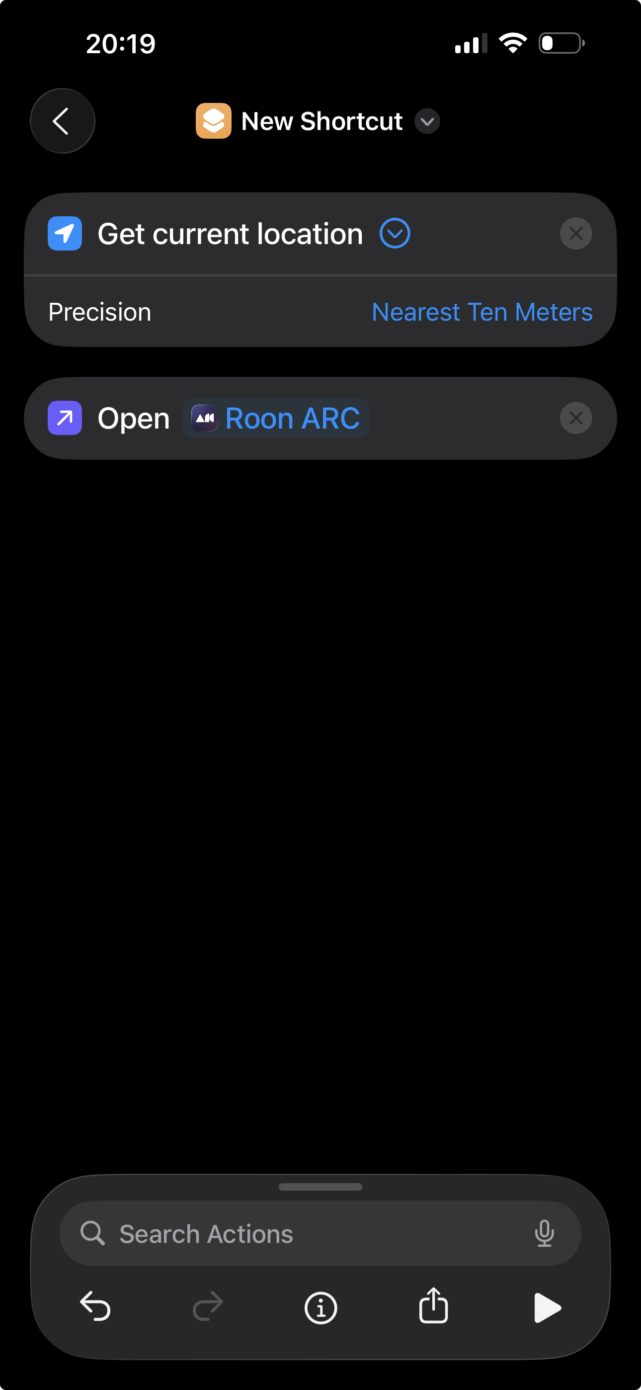

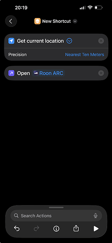

You can already do that, I think. On an iPhone, you can create an automation in the Shortcuts app that launches an app based on the phone’s location. I suppose Android has something similar.
