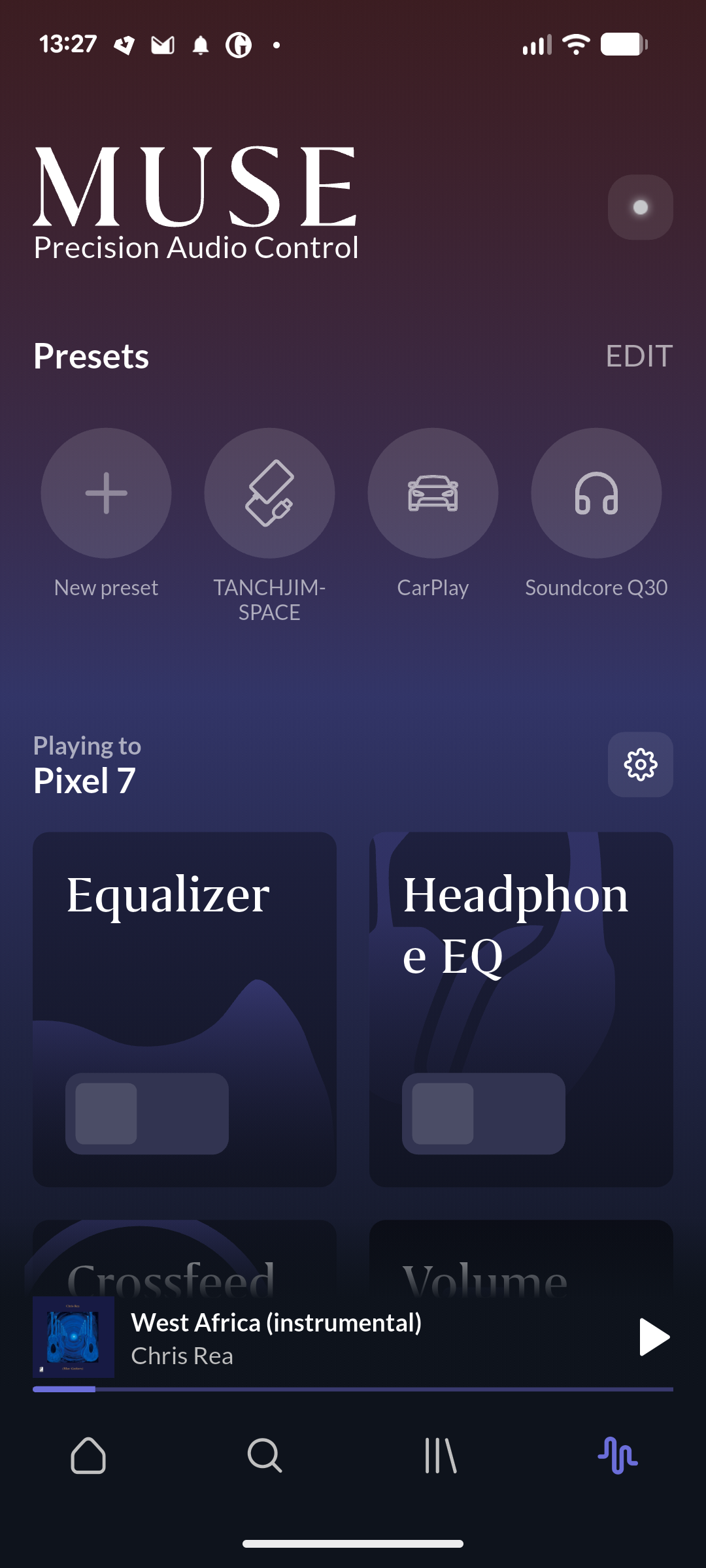

MUSE settings have playback profiles that can be associated with each of your environments.
I forgot about this because it is applied without intervention.
Indeed a nice way! I didn’t realize it did this without intervention. I better delete my feature request
The Muse listening profiles don’t govern the playback quality, you would still have to change that every time in the settings. But you don’t have to change anything since AptX is maxed out anyway
They can be used to govern sample rate conversion.
