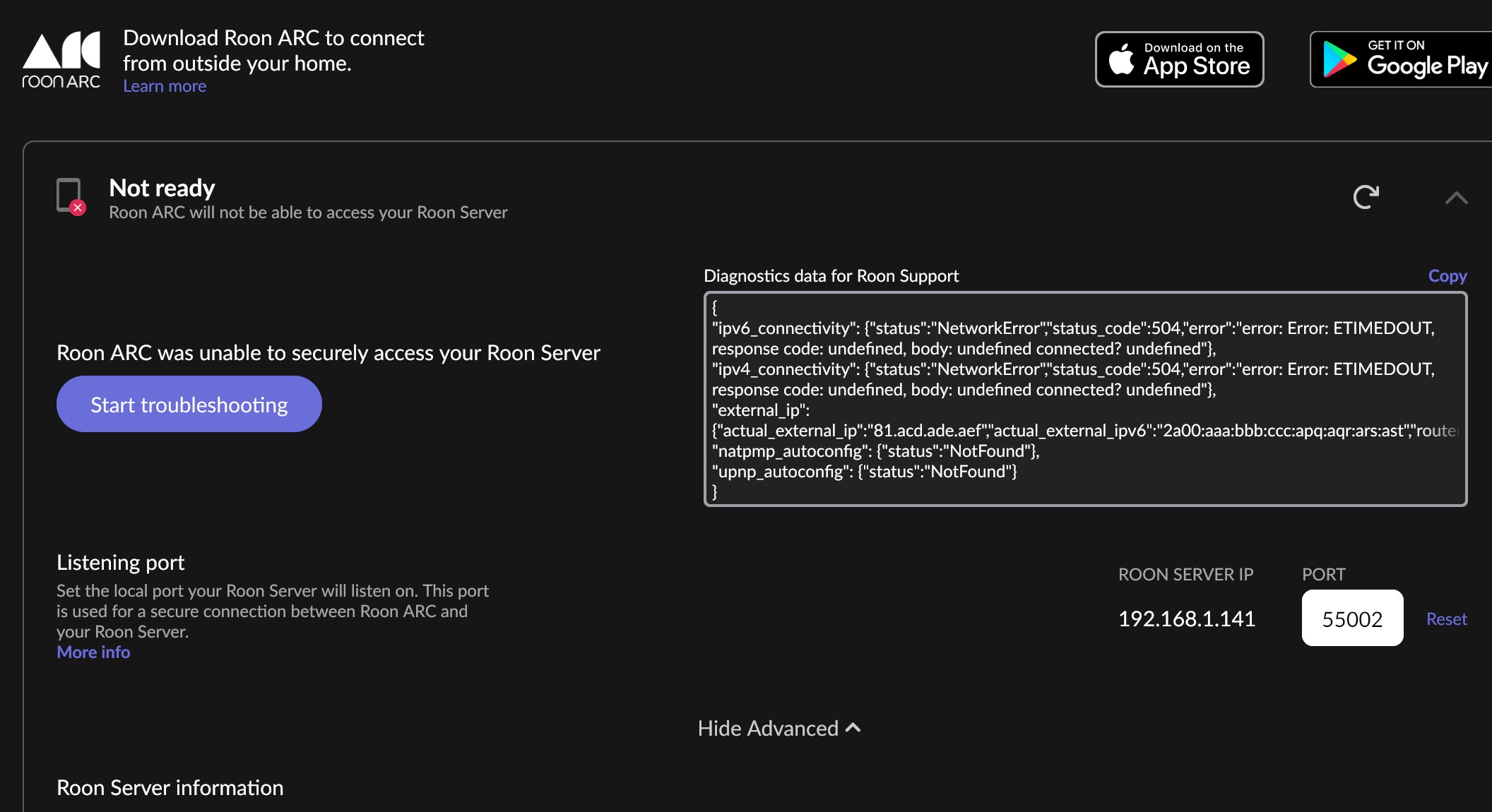

Roon Arc Port issue - Error
"ipv6_connectivity": {"status":"NetworkError","status_code":504,"error":"error: Error: ETIMEDOUT, response code: undefined, body: undefined connected? undefined"},
"ipv4_connectivity": {"status":"NetworkError","status_code":504,"error":"error: Error: ETIMEDOUT, response code: undefined, body: undefined connected? undefined"},
"external_ip": {"actual_external_ip":"81.acd.ade.aef","actual_external_ipv6":"2a00:aaa:bbb:ccc:apq:aqr:ars:ast","router_external_ip":"null"},
"natpmp_autoconfig": {"status":"NotFound"},
"upnp_autoconfig": {"status":"NotFound"}
Have you configured Port Forwarding on your router?
It looks like you have uPnP turned off so, unless you have a manual port forwarding rule configured, ARC will not work because your Roon Server is not accessible from the internet side of your router.
As described in the linked article above, you need to forward TCP connections on the configured ARC port (55002) to the ip address of your Roon Server (192.168.1.141).
If you use a manual port forwarding rule (instead of using uPnP), then it is also a good idea to create a DHCP reservation for your Roon Server so that it always gets allocated the same ip address.

The Internet provider was BT Business - The Port fording had suggested a port number but wasn’t recognising this on refresh.
I noted the network was through a network switch so bypassed this and refreshed the Port Forward referred and entered the 5 digital ref number in (to & from ) sections - Had to refresh all devices and restart network to make establishment - all works fine now. Thank you.
