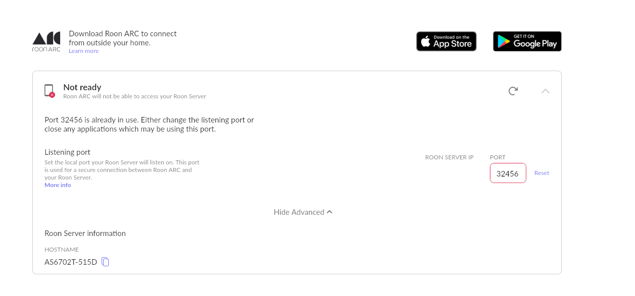

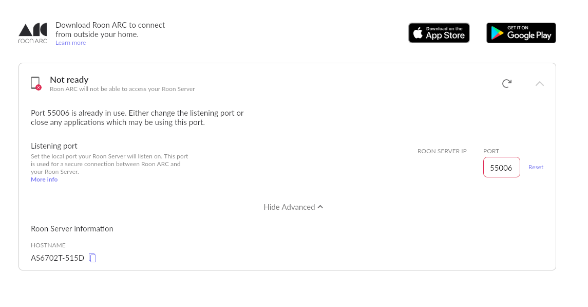

Having gone through setting up ARC with manual port forwarding, I went to do the same, set it up with a dedicated port on the modem, but in Roon’s own screen I now get a message whichs says that " port is already in use" regardless of which port I put in (I tried many, while making appropriate changes in the modem settings), it doesn’t even try to do anything. The port box is always circled in red. There isn’t the usual box with the copy/pasteable code that was there before. Here’s a screenshot
I don't know if it is relevant, but when I go to the ARC app on my phone, I get three different Roon Server options, two of which refer to the same device (the correct one). Here's a screenshot of that as well, but the main issue seems that I can't move past the above screen regardless of the port picked and appropriate changes I make in the router settings ![F711AB99-0171-427D-9730-727050F5CB5C|230x500](upload://8oiS8dkCT8S0CJrUdJOyd0enflc.jpeg)

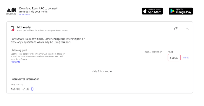

Just went through all the steps and that has absolutely nothing. No change whatsoever. Roon app isn’t even trying to check a port - it just says port not ready by default before even any port number is inputted. Isn’t it at least supposed to show the IP address of the RoonServer?
As you can see, it’s not doing even that
Twiddling with different port ranges and manual forwarding rules does nothing
