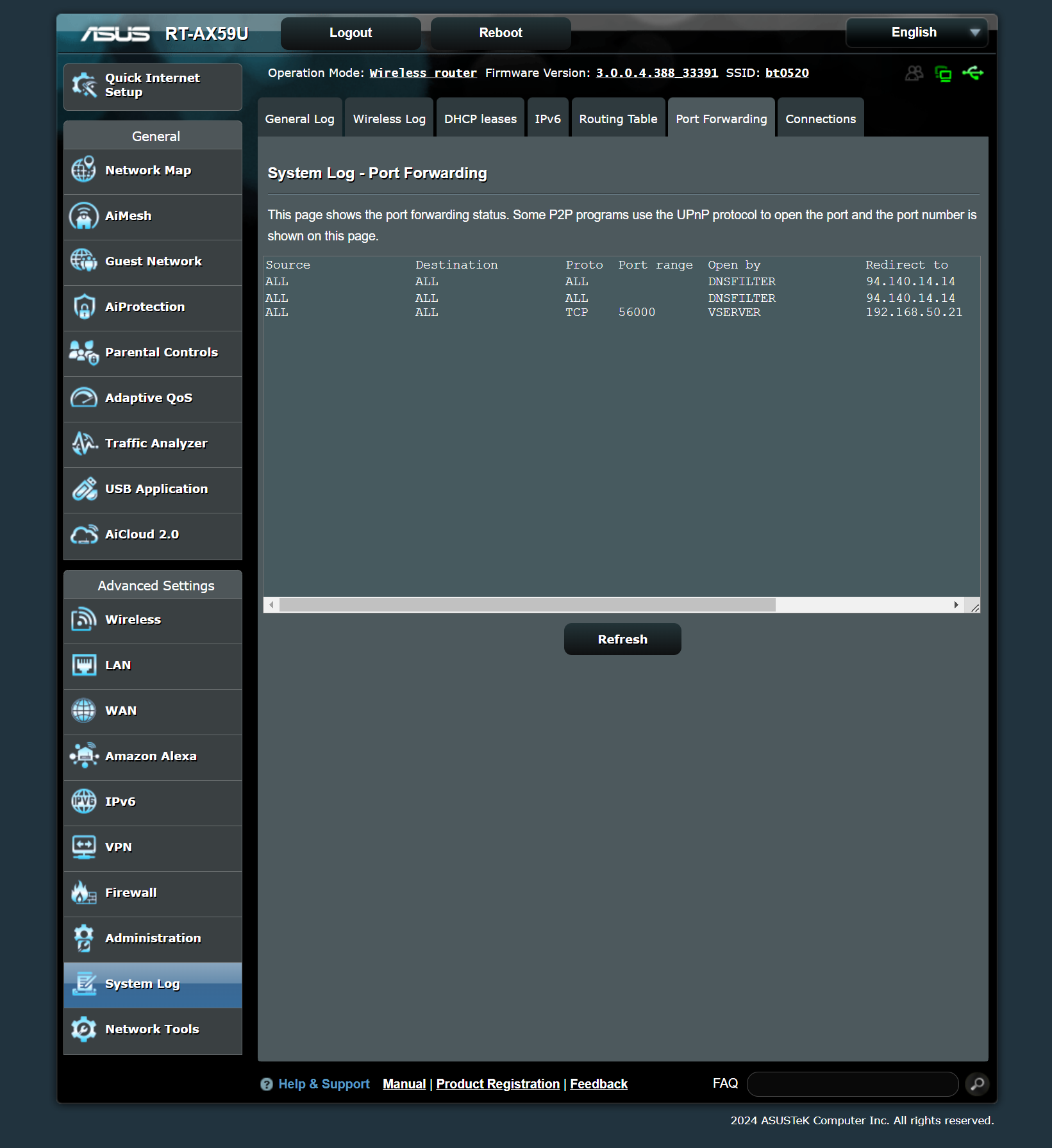

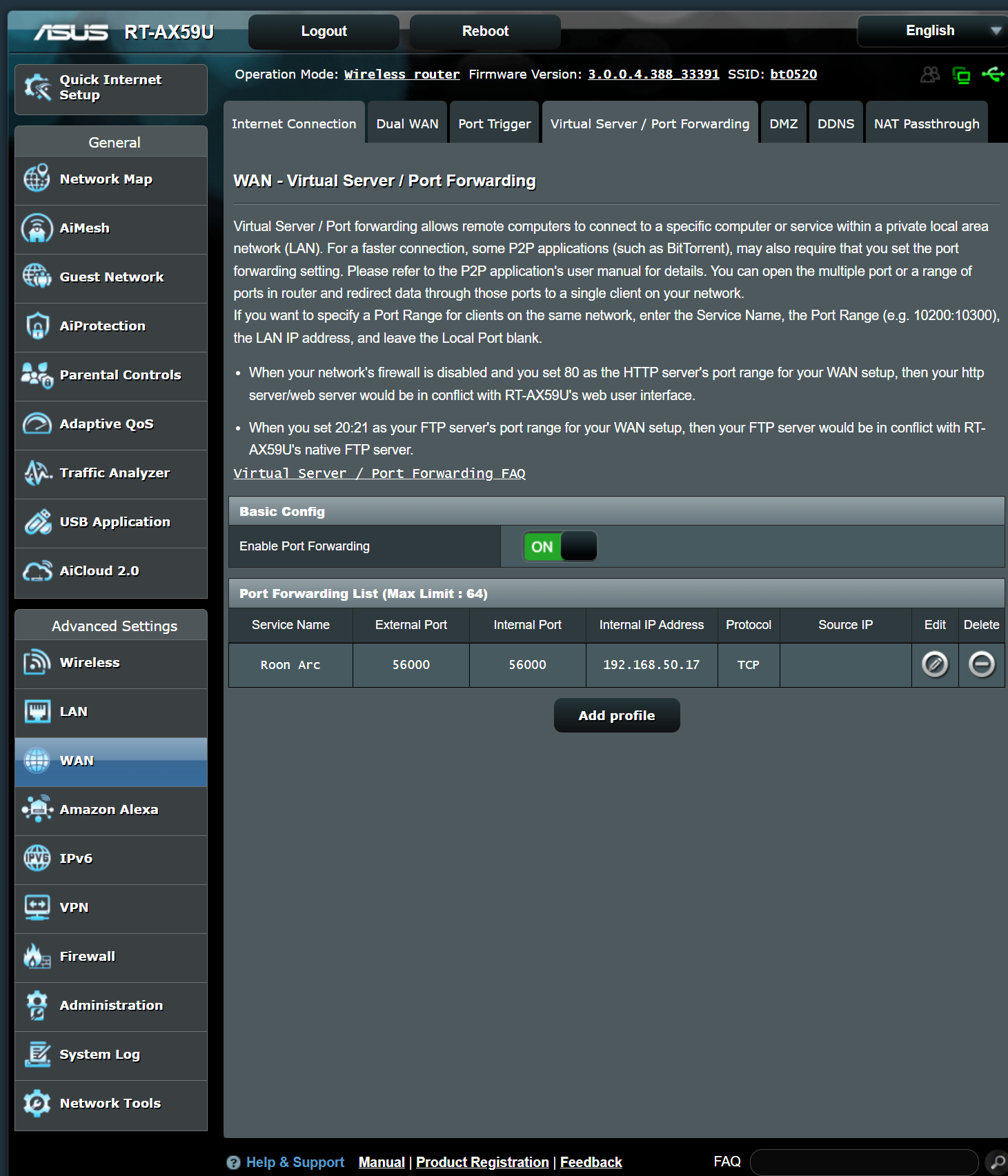

On your asus router, what does your port forwarding log look like.
If you go to the port forwarding log tab on the system log setting, it should show all of the port forwarding rules that you have in place.
e.g, for my router (also an asus), I see:
Note: I don’t use uPnP so all my port forwarding rules are manually configured. If you use uPnP, your rules may appear in the lower part of the page under the “UPNP, NAT-PMP and PCP forwards” heading.

This is not the same page. This is the WAN setting page where you add an explicit port forwarding rule.
If you go to the system log (on the left near the bottom) and then select the ‘Port Forwarding’ tab, you should see both the explicitely added rules and the rules added by uPnP/natPmP.
However, if you have uPnP turned on and you have this explicit rule, it may explain why you are getting the ‘ConflictInMappingEntry’ error in the diagnostic text.
You should either (both not both):
  • Delete the explit port forwading rule on the page thatyou have just shown and let uPnP configure the port forwarding.
  • Turn uPnP off (and use the manual port forwarding as you have it at present).
If you do the latter, a manual port forwarding rule, it may be a good idea to use a DHCP reservation to ‘reserve’ an ip address for your Roon Server so that it always gets the same address. This can be done in the DHCP tab of the LAN settings page. If you do not do this, then, at some point in the future, the ip address allocated to your Roon Server may change and then your explicit port forwarding rule will cease to work.
DHCP address reservation gives you many of the advantages of a static ip address for a device on your local network without the possible issues in the future if/when you change routers or, for any other reason, change the subnet that you use on your LAN.

Also, where have the two identical dnsfilter entries in your port forwarding rules come from?

This is the port forwarding log tab:
I did only done the port forwarding for the Roon Arc. The dnsfilter is directing to AdGuard which I have no idea how to disable it.
