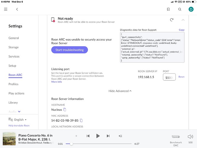

FYI, the Roon ARC screen shows the correct Roon Server IP address. It automatically shows use of Port 55000. I don’t know if changing the port would help, and I don’t know to what it should be changed.

Which usually means the Router’s UPnP is not on. First verify that you are not using any VPNs on the PC which is also running RoonServer. If so, disable the VPNs and see if things change.
Turn on UPnP on your router and try to run Roon's port forwarding test again.
Try to set up manual port forwarding in your router.
Make sure the IP/Port matches in any port forwarding rule you create.
Double-check to make sure you don't have any VPNs, Firewalls, or other network filtering software blocking Roon.
Check if your modem is in Bridge mode.
Restart your network hardware and update firmware.

If you enable UPnP successfully but receive another diagnostic message in Settings → ARC, please paste it here.

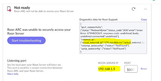

Thanks for the helpful tips. My ISP is Spectrum, and I’ve verified that it does not use CG.NAT. I get a public IP address for my Nucleus starting with 192, not a CG-NAT address starting with 100. My Netgear router firmware is up-to-date (I checked). It has UPnP enabled (I also checked). My RoonServer is my Nucleus - it is not on a PC. The Nucleus is directly connected by Ethernet to my router and modem. So I believe my RoonServer is not being affected by VPN. I do normally run ProtonVPN on my iPad which serves as my Roon Remote, but I have tried turning ProtonVPN off on the iPad and that does not help.

Just to be clear, this is NOT a public IP address (i.e. publicly visible out on the internet); it is an address that is inside of your home network, visible only to devices on your home network that are also within the address space of 192.x.x.x.
I use ProtonVPN, but it only affects my iPad which is my Roon Remote. My Nucleus is connected directly by Ethernet to my Nighthawk router and modem. In addition, I’ve tried this with ProtonVPN turned off, and that makes no difference.
I’m not sure what the consequence is from my public IP address starting with 174. Is there something I need to do because of that?
