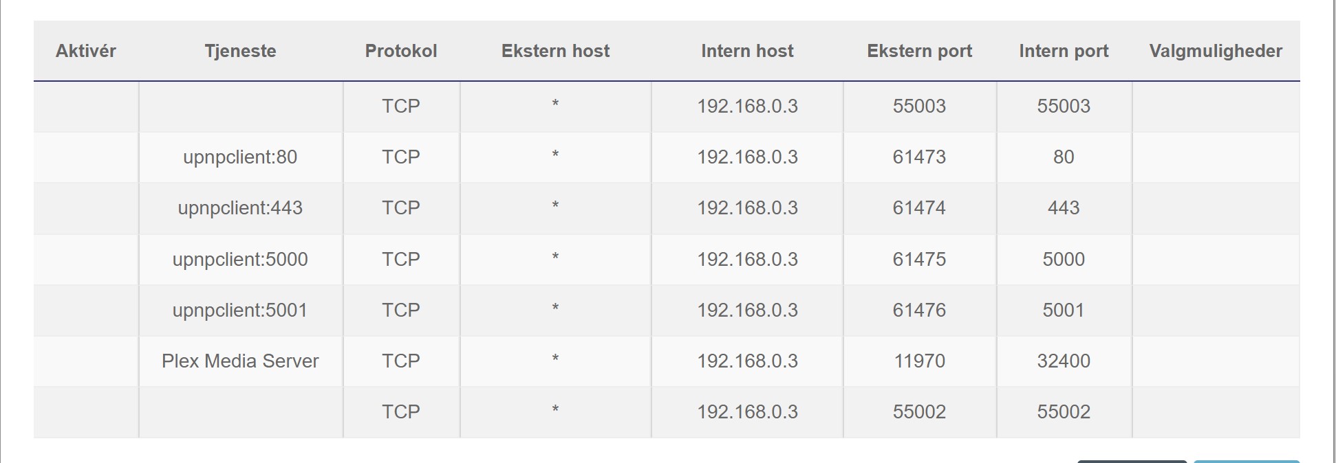

Hi Guys
I use a Sagem Router and access point are netgear RBK850 and RBS851
The sagem router is setup as main router and the others as AP. All setting in netgear is greyed out.
Big change from start of today is a changed sagem from being brigde to now router.
Upnp now works. but synology is failing when i test the connection.
I have attached screen dumps from router and synology who seems to talk just fine to setup the roules.
Get this error now:
“ipv4_connectivity”: {“status”:“NetworkError”,“status_code”:504,“error”:“error: Error: ETIMEDOUT, response code: undefined, body: undefined connected? undefined”},
“external_ip”: {“actual_external_ip”:“212.aaa.bbb.mmm”,“actual_external_ipv6”:“null”,“router_external_ip”:“100.kkk.jjj.lll”},
“status”: “status”: MultipleNatFound
“upnp_autoconfig”: {“server_ip”:“192.168.0.1”,“found_upnp”:true}
