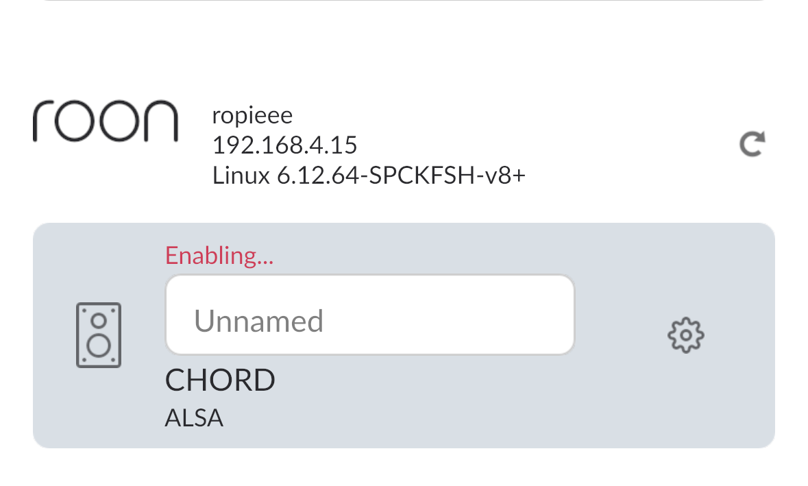

My Roon ROCK can’t enable Chord DAC on updated RoPieee. That’s never been a problem before. Persists after power cycling both ROCK & RoPieee. Disable/enable device fails to fix it

Ah, that’s what I was focused on. My bridge is inaccessible after accidentally choosing today to update Ropieee and inadvertently getting the broken update. Really not impressed by the seeming absence of testing on this release.

@spockfish - I don’t suppose there’s a simple way around this in RoPieee, i.e. a way to downgrade the Bridge back to 1.8 until this mess is sorted by the Roon team? Am presuming not but thought I may as well ask! Thanks :grinning_face:
I’ve got the same issue, running two RPis, one with Ropieee and the other Gentoo Player, and it has happened on both devices, constantly “enabling”. Hoping Roon can fix this pretty quicky!
I don’t think so… a long shot might be that they did not update the downloadable bridge (yet), so that you might receive an old version upon reinstall of RoPieee.
That can be tested rather quickly by choosing ‘Reinstall Roonbridge’ in the advanced menu, but again I think that’s a long shot.
Hi Harry I tried that on DietPi X86 and the new 2.6 version was downloaded. Though interestingly when I did it on the Audalytic RD70 version 1.8 was downloaded
I just tried reinstalling it on Ropieee and 2.6 came down again. That suggests Audalytic downloaded the version and is pointing to a downloaded version.
Thanks Harry - yeah, I gave that a go but sadly no joy. Worth asking :grinning_face:
Guess I’ll just have to be patient….but it’s very frustrating to find a perfectly functioning endpoint is completely disabled due to a botched release. I realise EA comes with risks, but I expect at least some testing to be done beforehand.
