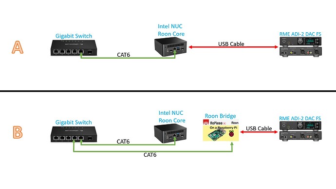

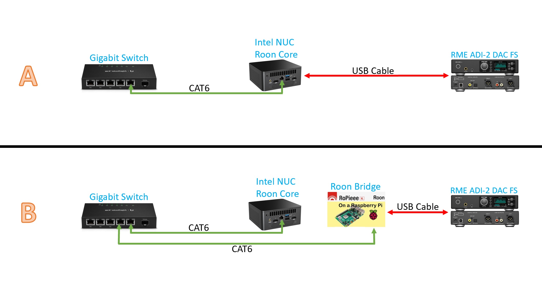

Sir Carl, which of these 2 connections is best to get the maximum audio quality output?
Both the same. I have the same dac and it made zero difference using a bridge or direct connected to the server.
Thank you very much Sir CrystalGipsy for your knowledge and experience you shared.

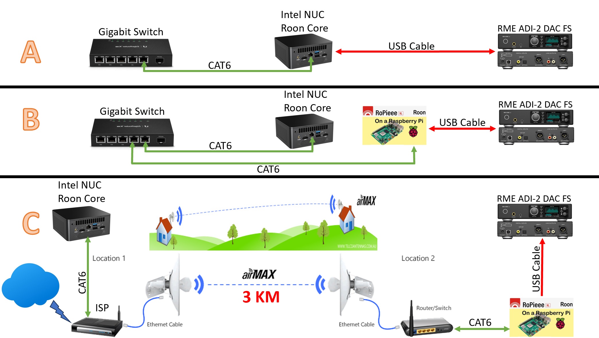

But how about this in option “C” ? Is this distance minimum 3 km it will work without audio quality degradation?
Why do you think it would make any difference at all. It’s just data transfer, this makes it or it doesn’t it can’t change the sq of it. You might suffer other issues related to poor data transfer if its susceptible to interference this will result in dropouts and the stream failing it won’t change the sound quality. I would imagine RAAT will not like the latency likely caused by such a connection and likely give issues related to this. Roon doesnt like high latemcy at all.
Next step for best SQ is one’s own geostationary satellite
From the point of view of sound quality, it will be the same with any of the three setups.
In regard the C setup, I have a similar setup with a couple of differences:
1 - The distance is about 500 m
2 - The Layer 2 protocol is Wi-Fi (CSMA/CA), yours is airMax (TDMA)
The good news (for me, at least) is that it works, even at 192 kHz/24 bits. I have not tested to higher data rates.
As @anon77144803 has said, there is an element that is out of your control: The radio channel.
