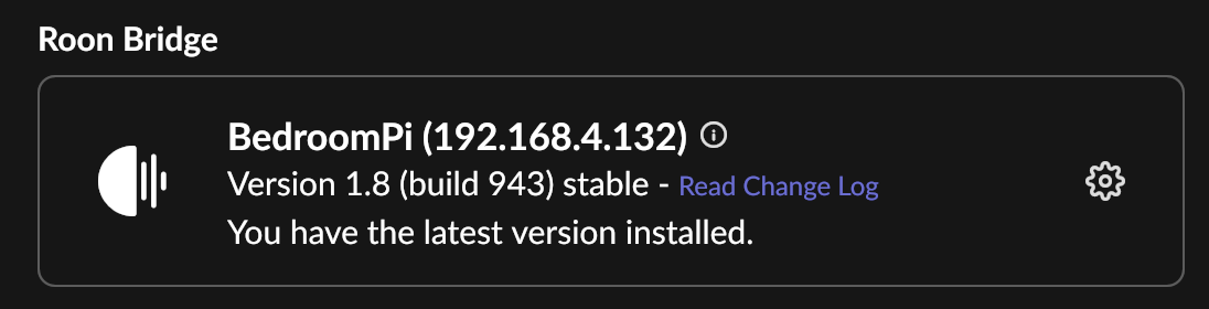

Not sure if this is related to a recent power outage (this morning), but roon isn’t seeing one of my RoPieee endpoints.
It sees it on the “About” tab (below) but not as an endpoint.
I had Airplay configured, and it could see the airplay endpoint, and roon seemed to play the track, but I didn’t get audio.
I disabled Airplay, and now the endpoint isn’t seen at all.
Thoughts?
Should I just reflash? (When in doubt, reflash?)
Reinstall roon bridge? (I guess I’m not sure what this does!)
Screen Shot 2022-08-31 at 7.25.03 PM
My other RoPieee endpoints seem to be fine. (Those are running HQPlayer, fwiw. This one isn’t.)
