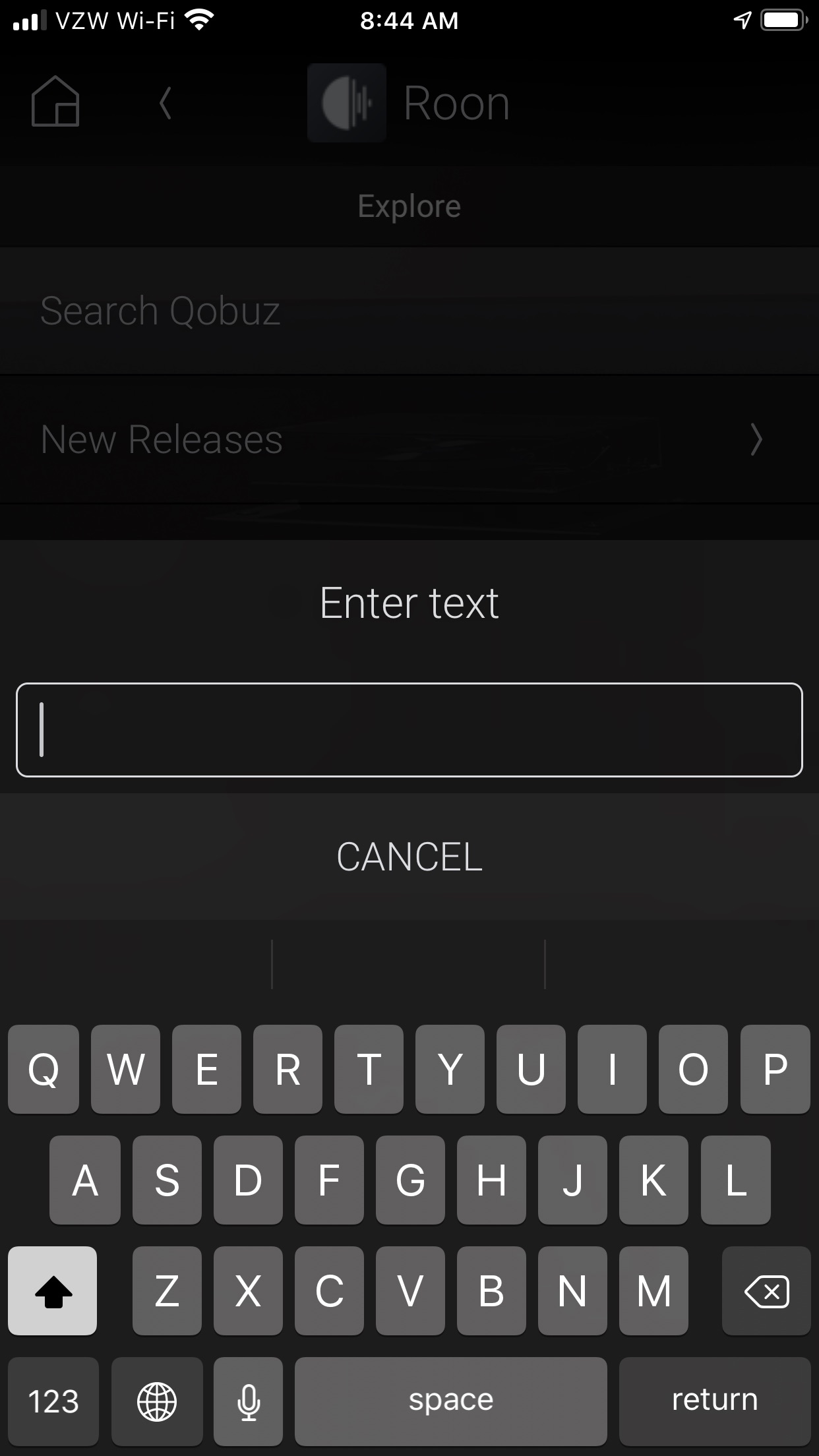

a. “Search” within the “Library” tab doesn’t work. When you type in an item to search for and hit “return” on an iPhone, nothing happens. The “enter text screen” just goes away. No search is actually performed.
i. This happens in Qobuz and Tidal, as well. It seems to happen anywhere I try it.
I haven’t yet had a chance to test this on a native Control4 touch panel. I will do so to make sure it’s not just an iOS issue.

I just tried to reproduce this issue on the Control4 T3 Touchpanel we have in-house and I am unable to do so, search is working properly on the panel. It is possible that this is an iOS/C4 Mobile specific issue. We currently don’t perform any testing on the mobile end since we do not have access to 4Sight, but I have requested that the technical team look into the possibility of adding mobile testing as part of module. I can’t make any guarantees here, but we’ll see what is possible. I would also check to see if this behavior impacts your Control4 touchpanels as well.

When I tried to search, this is what I got: The search bar comes up, I enter an artist name or whatever, then hit search. The search bar disappears, and nothing happens. I’ll test this again next time I am in the office.

For the issues on the Control4 iOS app, I would kindly ask that you test for the behavior on a native C4 touchpanel. I am unable to reproduce the search issue and the new playback session issue on a native C4 panel, so I suspect that just the mobile version is affected by these issues.
As I mentioned earlier, I’ll try to see if we can get access to mobile platform testing, but at the present time we don’t perform any testing on the Control4 mobile version, so currently it is a bit difficult for us to file tickets and make improvements for issues that occur on non-native Control4 touchpanels.
