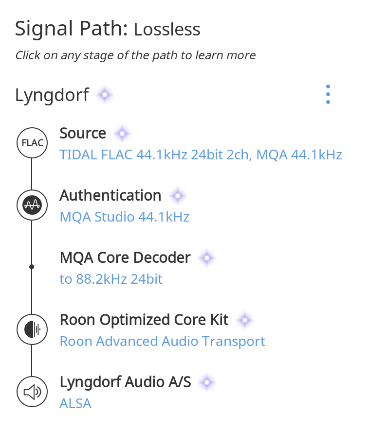

Currently, my Roon Core (which is running on an Intel NUC) is connected to my Lyngdorf TDAI-2170 USB input via Ifi-audio Micro iUSB3.0 in between. So, it’s as below:
And this is how the signal path looks like:
Not that I am an not happy with the set-up but I’m thinking about what can potentially improve it.
