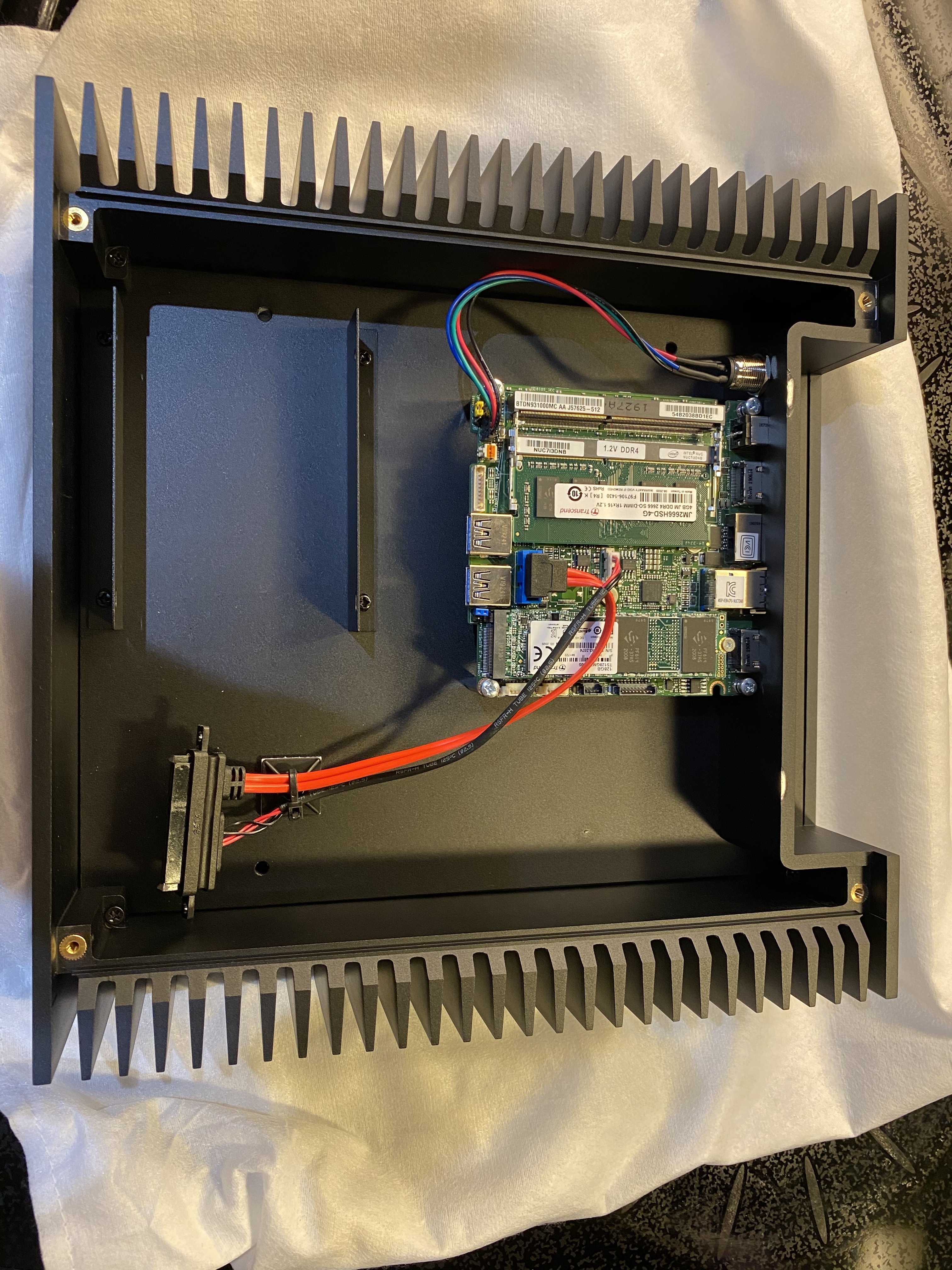

The computer was built and here is some pictures without the cabinet cover on:
Pictures before the 2TB SSD was inserted (Late delivery)

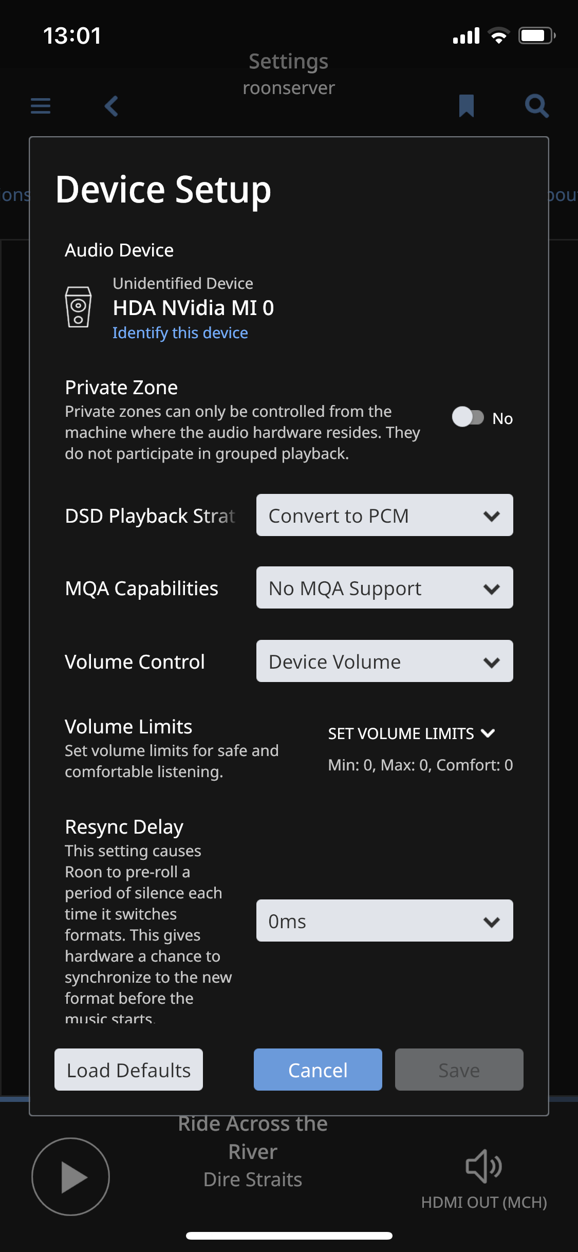

Next, I had to enable the HDMI port as a zone in the Roon settings.
Followed this guide: Link
In the end, I finally could play DSF64 5.1 files out from my Roon Core and other multichannel albums in FLAC or DVD-Audio format I had in my library. I could see that the Roon Core was converting it to PCM and Channel Mapping from 5.1 to 7.1. But, there was something really strange with the sound…I could clearly hear a some kind of a “surround echo”. It sounds like all the instruments were in all channels and really sound bad for me. The 861 was set to same presets as before when playing multichannel, but there was something wrong.
