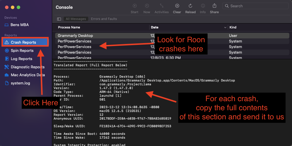

Including a wide variety of different boxset tags. So we can provide the team a better idea of what exactly is occurring during the crash, we are hoping you can provide the logs directly from the Mac. Please see the following steps:
Open Console.app
(this is part of mac os x. You can command-spacebar and then type “console” to find it).
Then go into the “Crash Reports” section, and see if you can find any Roon crashes in there.
For any crashes, paste the contents into a text doc and then upload the crash report here and let us know once you’ve done so
