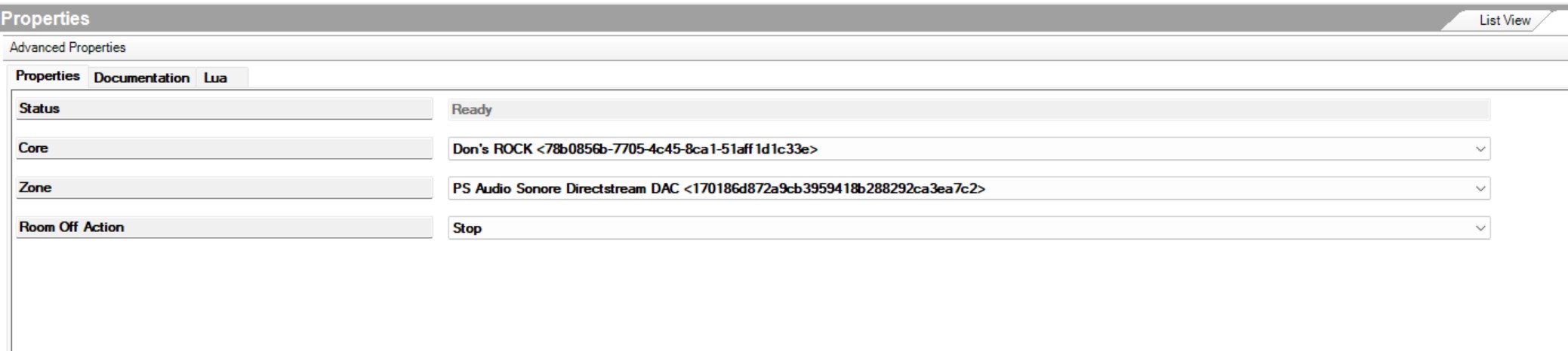

Issac, sorry it took so long. Unfortunately, been away from home for while. So, here are 3 screen captures. Not sure they’ll help but here it is.
Core
Thanks for that. My drivers’ properties look yours. I have an idea what might be contributing to my issue but I need to set up another spare controller on 3.4.2 to do so, and I haven’t had time yet.
