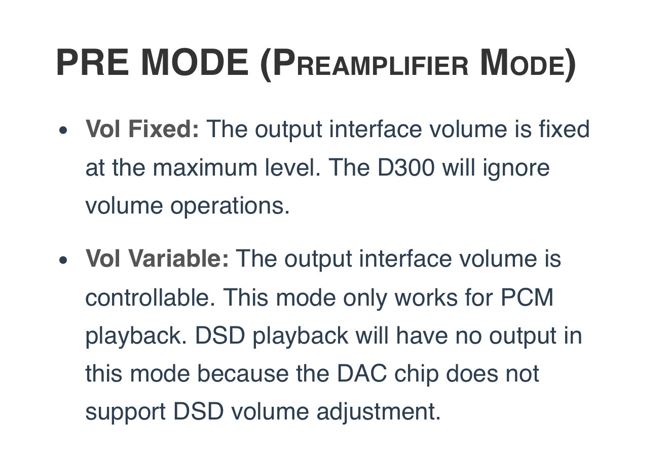

Firtly, check the D300 is set to fixed output and not variable. The manual states this for DSD to work.
Thank you.
The D300 has a fixed volume.
But the results were the same.

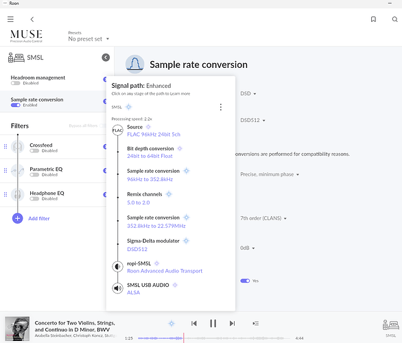

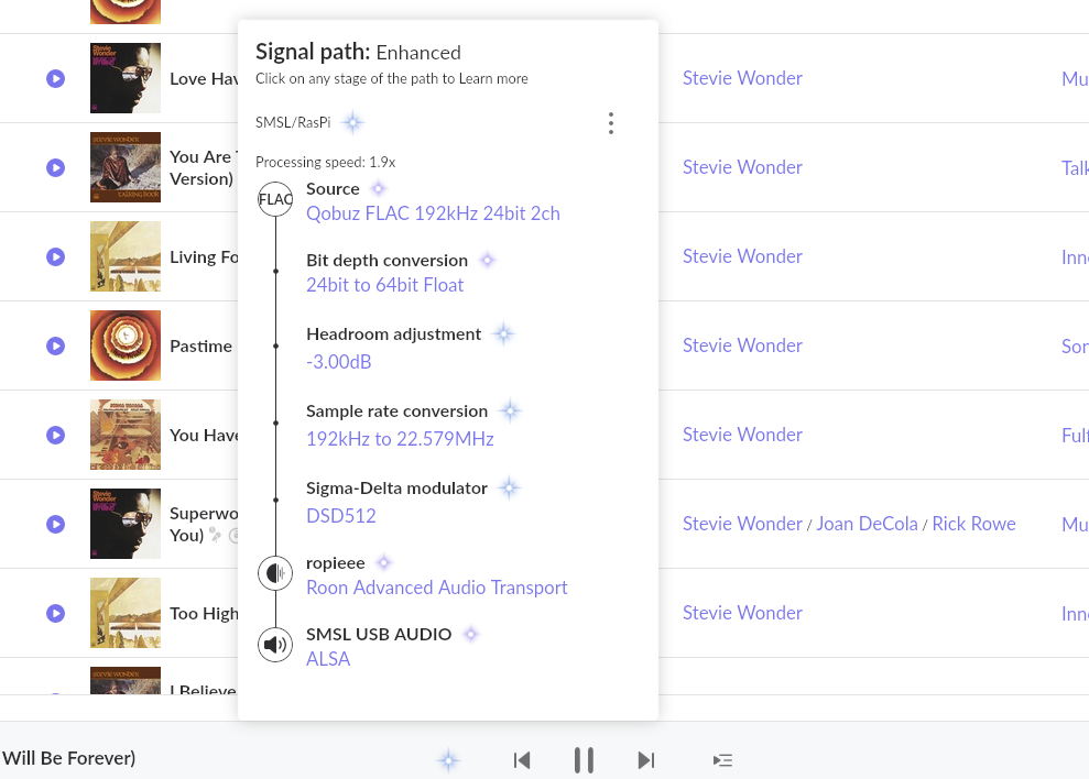

Could you post a screenshot of the signal path when playing a DSD track?

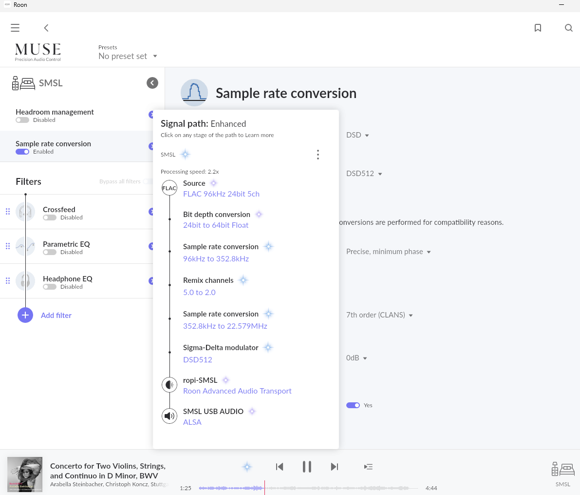

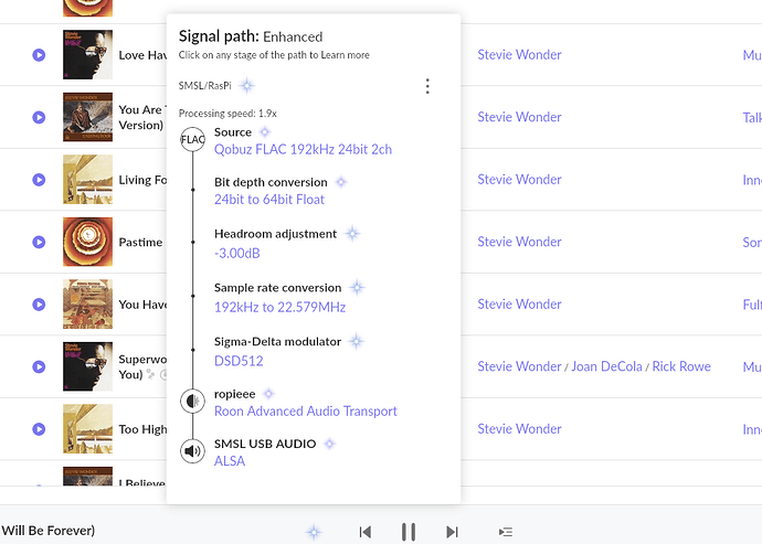

This is the signalpath.
I’ve also included some other screenshots.
Ah, you’re upsampling.
Ok.
Try DSD256 instead of 512.

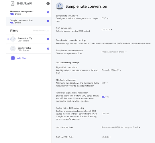

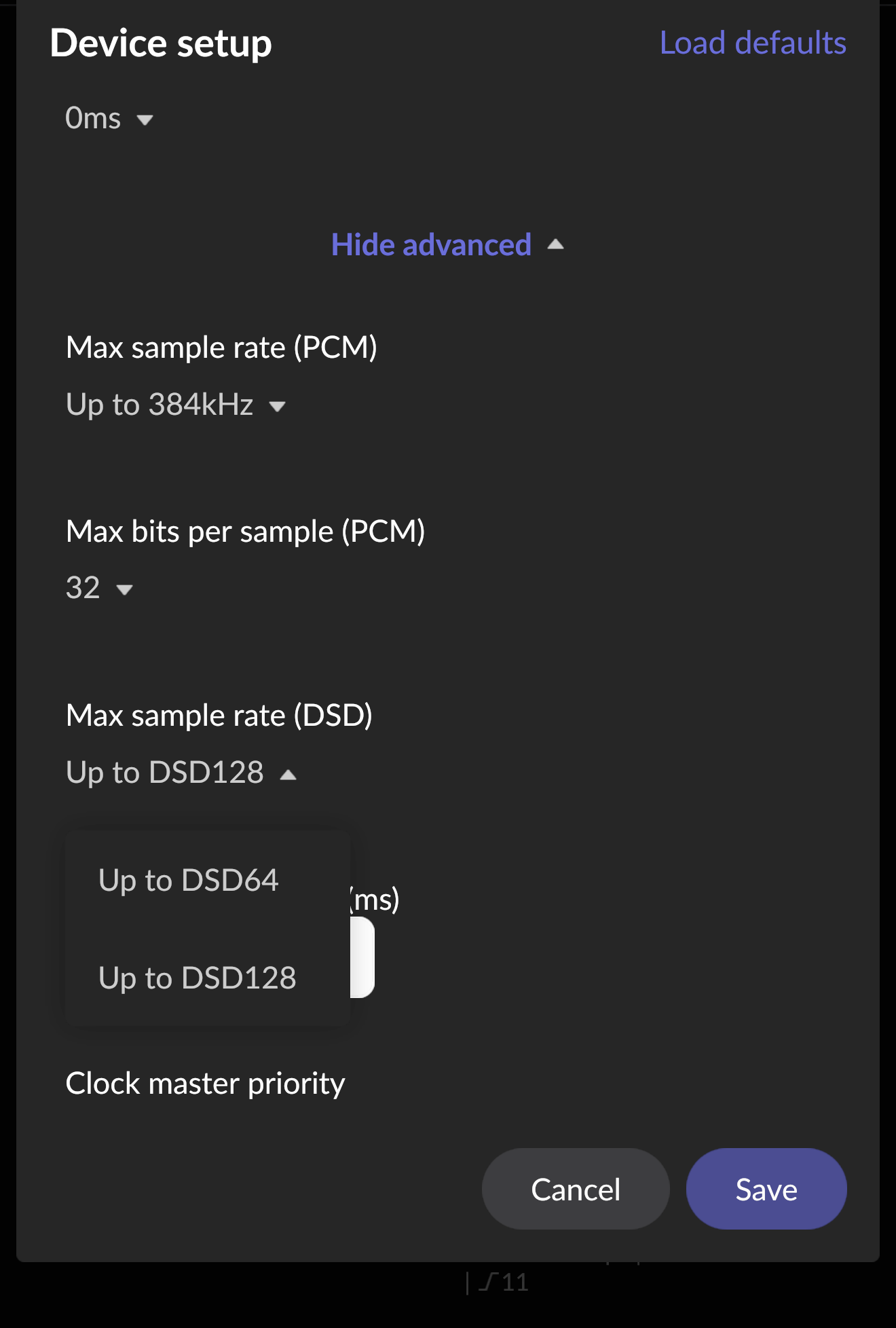

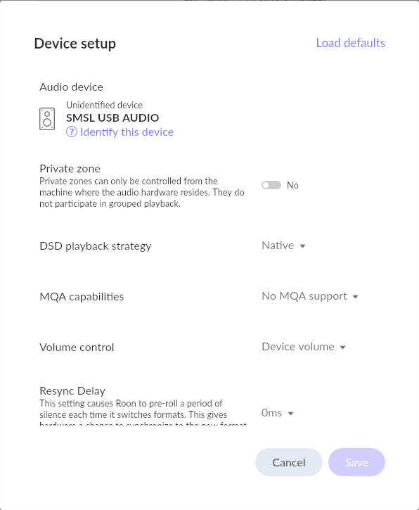

On the last screenshot, scroll to the bottom of that settings page and expand the ‘show advanced’ and post the screenshot of that section.
Like this

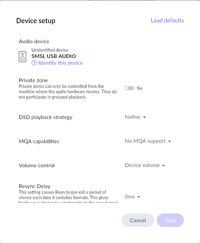

Your Device setup screen Volume control setting reads Device Volume.
Please set it to Fixed volume instead and see if that fixes your issue.
P.S.:
I highly doubt, that upsampling or PS choice cause what you’re experiencing, as processing speed is at 1.9x and no stuttering or Ropieee dropping off the network are reported.
I had considered the ‘device volume’ being set, but I checked and if RoPieee is set to fixed, Roon still can show ‘device volume’ but actually is fixed within Roon.
Funny thing, I have set RoPieee to not be fixed volume and Roon is still set as device volume, but still is fixed volume :man_shrugging:

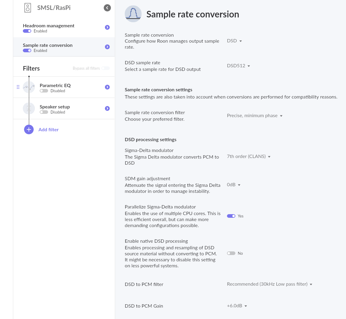

Me playing a 16/44.1 upsampled to the exact settings, although DSD256 shows a processing figure of 4.3x

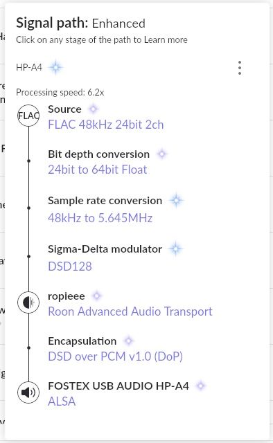

I tried switching to the FOSTEX HP-A4 and playback worked without any issues.
So I think it’s a compatibility issue with the D300.
