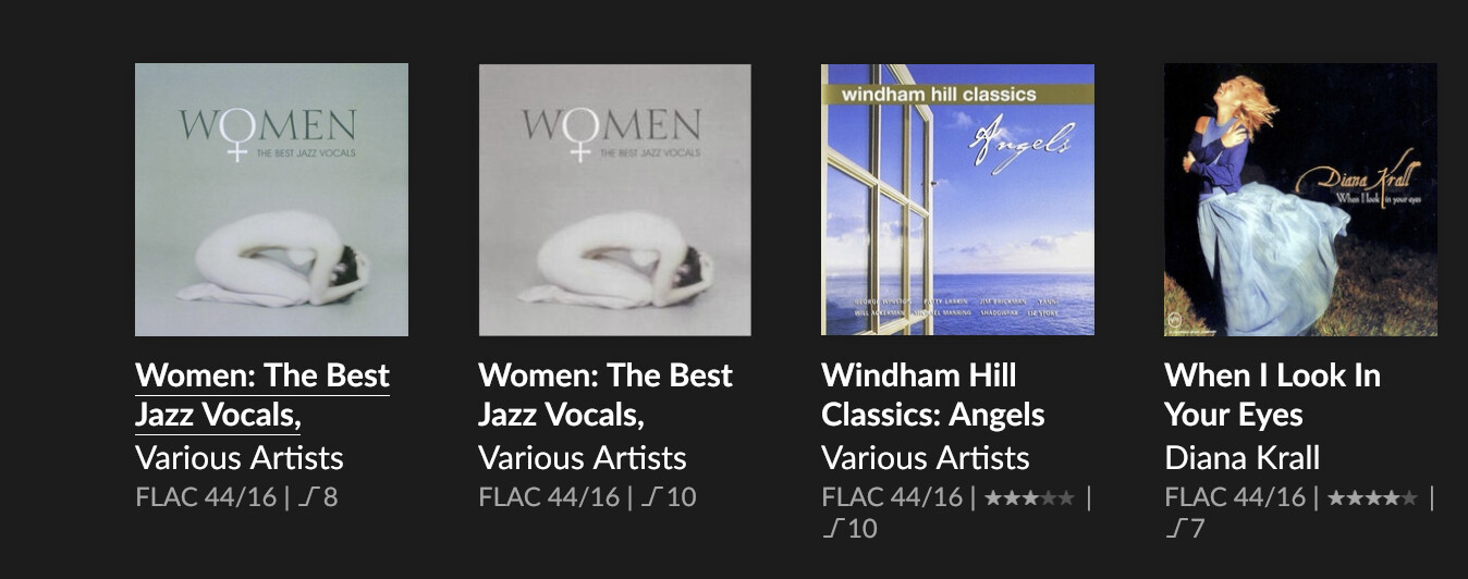

Well what happens, I don’t know why Roon keeps replicating some albums within the library.
The example I showed in the photos, in Box 1 I have 58 CDs but Roon doubled it and shows me 75 CDs.
I took due care when ripping, each CD is properly separated, as if it were an album, physically and what is inside the folders is exactly the same thing.
The problem is in the way Roon finds and shows, replicating things and showing more than he should.
There are also cases where Roon takes just one song from the CD and separates it as if it were another CD, but the digitized album is in just one folder.

Maybe several albums have been split into several due to contradictive metadata (e.g. different primary artists, wrong disc numbers or alike). The different DR calculation of the 2 albums hint that the tracks are not identical.
Did you try marking the 2 same albums and merge them into one?
If that happens many times, you might want to check basic tags such as album artist and disc number with a tag editor. It helps automatic identification by roon.

Just a couple of pointers for box sets , if you are not already doing this. The same applies for single disc albums apart for folder naming.
Use an external tag editor to fix the tags before dropping into the Roon Watched folder . MP3Tag is free and good.
Make the album name the same in all cases =“Box set name”
Make Artist the performer by Track
Make Album Artist = Various Artists if several but same for all [album artists]
In your folder structure use a Master folder for the Box then sub folder for each disc named CD1, CD2 etc NO additional text (IF Roon sees “CD3 - Nice Jazz Music” it will assume a separate album and split it off
Make sure the Disc # for the CD is the same and matches the folder name eg CD3 Disc # 3

And I just noticed that I don’t think you’re talking about “box sets” here in the usual sense? So then I would look at the metadata - what are you using to rip the CDs and do you check the quality of the metadata after ripping?
If Roon is splitting albums, it means that it hasn’t been able to identify the album from the metadata properly, and this is usually down to an issue with the metadata itself.
And a further investigation shows that your example (Women: The Best Jazz Vocals) is in fact a 2CD album - so indeed this is a “box set” and should be ripped and stored in folders following Roon’s naming convention for proper identification.
I don’t think that this is a “problem with the Roon database”, but with your metadata and folder structures.
