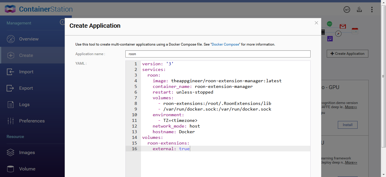

It should show up. I does on mine. Make sure you run the newest extension manager image. For docker extensions make sure you have the docker.sock mounted.
I think thats just make sure you run it using network config of host rather than NAT when creating the container. If you use NAT then it wont show any extensions as being available at all…

There are extensions – like e.g. CD Ripper – that get distributed as docker image only. If docker is not available, these extensions don’t show up.
Yes, that’s this option: -v /var/run/docker.sock:/var/run/docker.sock
I got it to show up by ssh and running this
docker run -d --network host --restart unless-stopped --name roon-extension-manager --hostname Docker -v roon-extensions:/root/.RoonExtensions/lib -v /var/run/docker.sock:/var/run/docker.sock -e “TZ=” theappgineer/roon-extension-manager

If your image is older, you should remove/delete your docker application and install new. You can use my docker compose I posted above. Go to Create, click on +Create Application (right side) and copy the docker compose instructions in the Create Application window.
