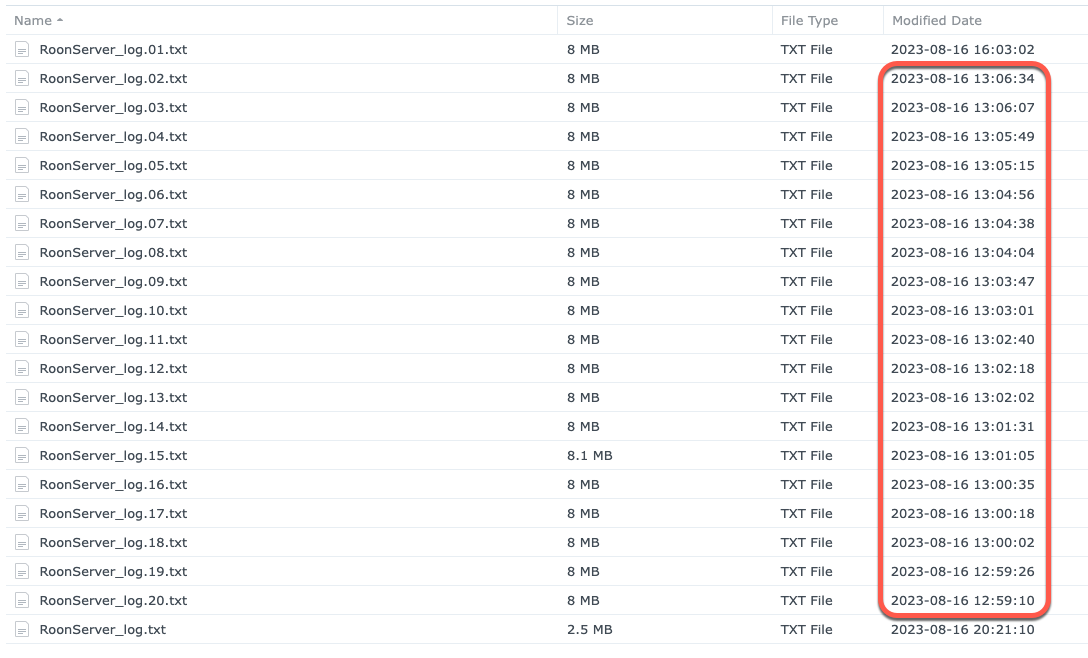

Today I noticed that my Roon docker container was using an unusual amount of RAM. More that 13GB compared to 4 to 5GB that I had been seeing before. Checking the log files, I noticed that in just a little more than 7 minutes, Roon created a total of 19 log files 8 MB each. There may be more, but I can’t tell as Roon cycles the log files. Eventually it did settle down.
When opening such a log file, it contained repeating blocks of entries, presumably generated by RHEOS. I base this on the fact that RHEOS is explicitly mentioned in these lines as well as the ip address that is listed, which corresponds to the docker container for RHEOS. I’ve included a sample containing 2 repetitions of a similar block of output below.

I’m not sure what this means or what caused this. I’m currently on the latest build of Roon, but I can’t say for sure that this did not happen before. Potentially this is the result of a little too much tinkering with docker containers on my side.
For now I’ve disabled the RHEOS extension. I’ll keep an eye on memory usage. But I may not be able to do a close follow up until tomorrow evening.
Any insight would be appreciated.
EDIT: Forgot to add - I did not stream to my Marantz during this time.
