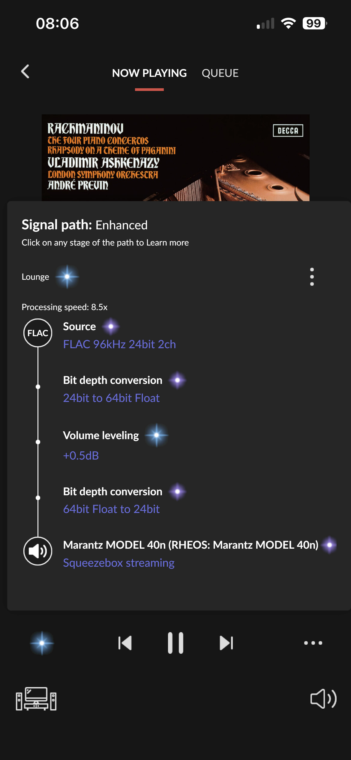

You can see it in the logs but easier to look at the signal path when it switches from normal track to one of the short ones. I could see it doing this on my classical album that’s got very short tracks and on the Beyoncé album. I use volume levelling but that’s all the DSP in my chain. But no way it should drop that low with my server it doesn’t register at all for regular tracks. It really shows an I/O issue from the extension with these tracks.

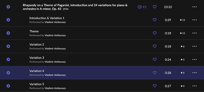

try this one, theme of paganini always causes me issues with RHEOS, I am not at home so cant try it out.

The Rachmaninov disc is fine its the Paganini thats problematic as they are all short tracks and should be gapless but has never played as such via RHEOS.

Most importantly both Beyonce and Paganini play perfectly (and gapless) with this version on my system. Please let me know if this doesn’t work for you (and try to collect logs).

Sorry lots of issues here. Using Paganini as my tests
First it doesn’t switch input to heos if play is pushed whilst in standby, this is something that’s started with all v.9. It’s sticking on HDMI ARC and play is stopped. When i hit play again playback was all garbled like it was having sample rate clock locking issues. Restarted playback of the material solved this but skipped to next track before first had finished and it played gapless for two tracks only. It does play now which is better and back to how it was. Processing speed randomly does seem to drop on some but not all.
Play track on its own it’s fine. So something going on with your caching is affecting this.
Beyonce now plays but is not gapless. When your looking at signal path you can see it go off and back at track boundary where gapless don’t.
Tried with larger buffers no different.
